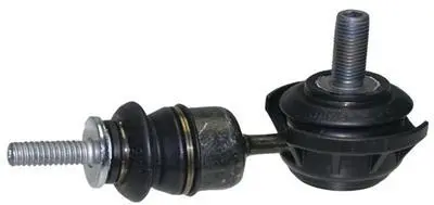

I noticed my rear end clunking as well and the dealership couldn't find out the problem...they said everything is in place. A few weeks later out of desperation I checked under myself and noticed my sway bar had a bolt loose. I don't know what the part is, but it's at the very end of the rear swaybar and has a 5mm (4?) allen wrench screw and 14mm bolt attached to some kind of joint looking thing. Anyways it was loose for I don't know how long, and now the screw has been damaged by the sway bar grinding on it. I was stupid and tried to tighten it myself. Now it looks like I messed with it. I hope the dealership will fix it for me under warranty..
Anyone know where I can get one of these besides the dealer?

I'm guessing one of three things:
Sway bar bushings -
Faulty shock -
Sway bar end links -
The bushings wrap around the sway bar which are wrapped by the brackets that hold the sway bar in place. At each end of the sway bar are end links, and finally the end links connect to the trailing arm/spring perch.
Of those three things, bushing are cheap and pretty easy to replace, next in line are the end links, and finally (and probably most expensive) is the rear shock.
