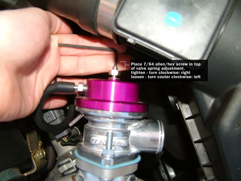

7/64th hex wrench/screwdriver thingy (see pic)
pliers - you can use 10mm socket wrench instead, but you'll need to remove the stock airbox to access the stop nut.
Step 1: Loosen the stop nut on top of your greddy by turning it counter clockwise (left)
Step 2: Place your 7/64 hex thingy in the top of your valve adjustment screw
Step 3: Tighten your valve adjustment screw by turning clockwise (right).
Here is where you should test your car at idle. Rev it up a few times and set it off. Tighten and/or loosen the adjustment screw untill it blows off at a setting you like with the amount of stalling you prefer.
Step 4: Retighten you stop nut and go for a test drive.
How much you tighten is up to you.
I tightened it until there were about 5 threads left showing on top of the stop nut when tightened (step 4). I now have NO stalling issues. The car will blow off under idle and the RPMs will drop till around 900-700 then stop dead. No more bouncing, no more stalling, no nothing.
When driving it blows off very quitely under 2500 RPMs, or 2500-3500 RPMs with no acceleration, and doesn't stall.
Under heavy load or high boost it blows off VERY loud, the RPMs drop to around 700-900 and stop. No stalling, no bouncing, nothing.
What happens is the valve spring is now tight enough to reseal itself early enough to prevent an excess amount of air from escaping. When you watch mine under heavy load conditions once the valve blows off the RPMs drop, then it seems to hitch for a split second around 1500 RPMs on its way down before stopping around 700-900 RPMs. My guess is the valve now closes at 1500 RPMs and the time from 1500RPMs -700RPMs is enough for the air pressure to equalize, or for the new air to work it's way through the system.
So now I have no stalling issues or turkey issues, just a clean loud greddy whistle and psssst.

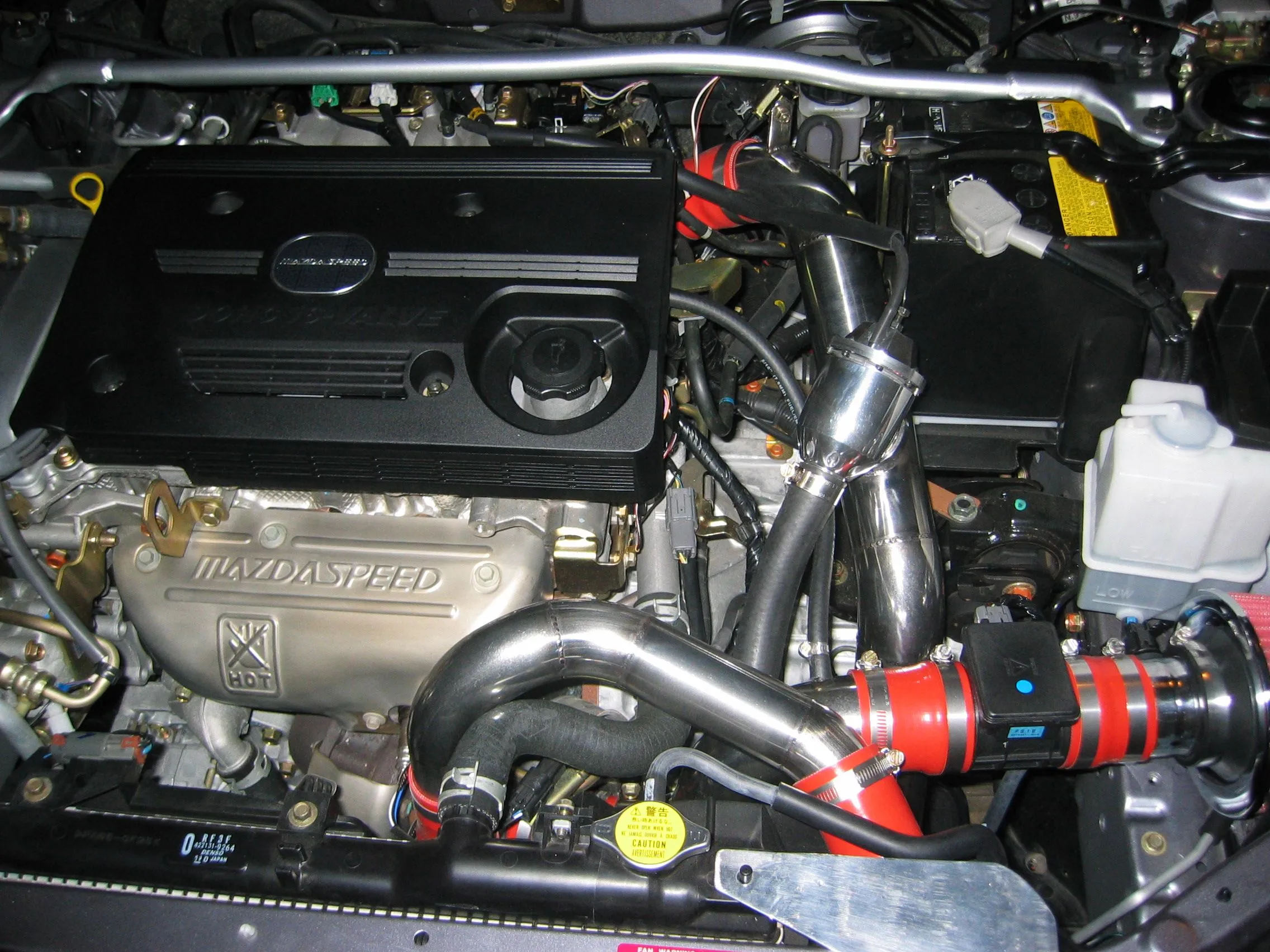

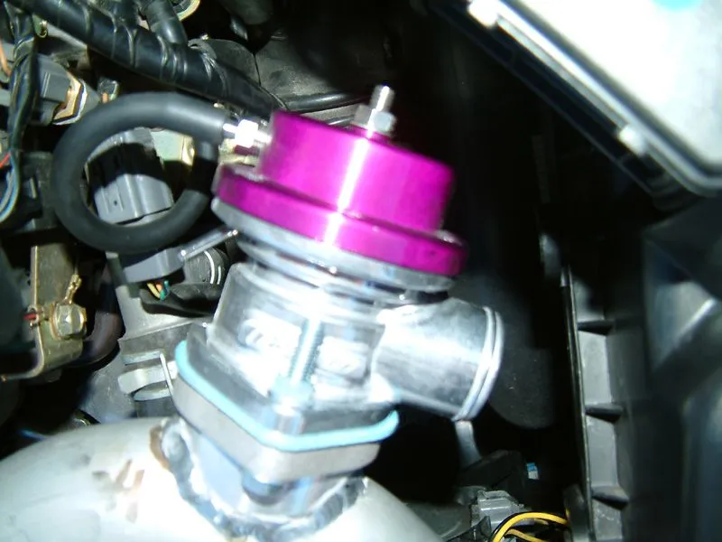

I definitely don't think JDM Sam's is in the same location as mine. Can you verify if it is. Here is a picture of my car in the attachment.
Can you also see anything out of the ordinary why I would be stalling AND the fact that I am experiencing the "turkey" or compressor surge - whatever you want to call it.

You are correct. Sam and I have our BOVs on the turbo-intercoller pipe. You have yours on the intercooler-throttle body pipe.
Mark94 said:
Can you also see anything out of the ordinary why I would be stalling AND the fact that I am experiencing the "turkey" or compressor surge?
Nothing looks out of the ordinary on your set up. You may be experiencing the turkey sound because your HKS is too tight. Since you are recirculating you should have you HKS at a very loose setting. If it's too tight it will not open quickly enough to catch the backlash of air. Try loosening it up a bit.
Also the HKS SSQV releases the air in stages, not all at once. So the sound isn't really a pppsssssssttttt. It's more like ppssstt ppsstt ppsstt in a very quick sequence and could possible be misinterpreted.
Since you are recirculating I don't see any reason why you would be stalling. Do the RPMs drop very rapidly and sometimes it stalls and sometimes it bounces and comes back to life? If so check your connections for leaks, research the HKS to make sure you have it recirculating correctly (you may need to buy some sort of adapter). If thoses don't work the replace it with the sotck BPV and see if that works, perhaps you just got a crappy valve.

...Nothing looks out of the ordinary on your set up. You may be experiencing the turkey sound because your HKS is too tight...
When I had only the SSQV recirculating, the turkey was the worst out of any of my setups. This is what it sounded like: http://www.wpi.edu/~jck15243/MOV00495.MPG
It sounds like Mark94 could benefit from the dual valve setup.:)

It looks to me like his return is too close to the maf. The maf could be getting getting confused by the rush of air that is coming back into the intake.
