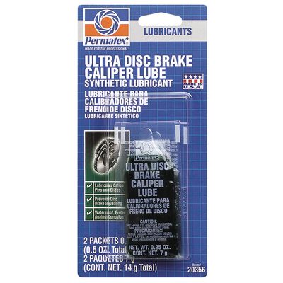

Honestly the packet is like $3 at autozone and is enough for one axle. Or you can buy the tube. Its green. I used the autozone brand in the grey packet and no squeakimg front or back when I changed my front/rear rotor and pads. http://www.autozone.com/brake-and-p...matex-ultra-disc-brake-caliper-lube/10772_0_0

HONESTLY, you don't seem to have read or understood what we all wrote... that "packet" are for pad shims, NOT slider pins.... of course there's no "squeaking"! It doesn't even matter what the packaging says... it's been tried and it doesn't work for slider pins... they dry up and get baked in, making it worse than not even using any grease on the slider pins at all!
This thread is about slider pins, not brake squeaking!
Don't give bad advice if you don't know what you're talking about, ok?
