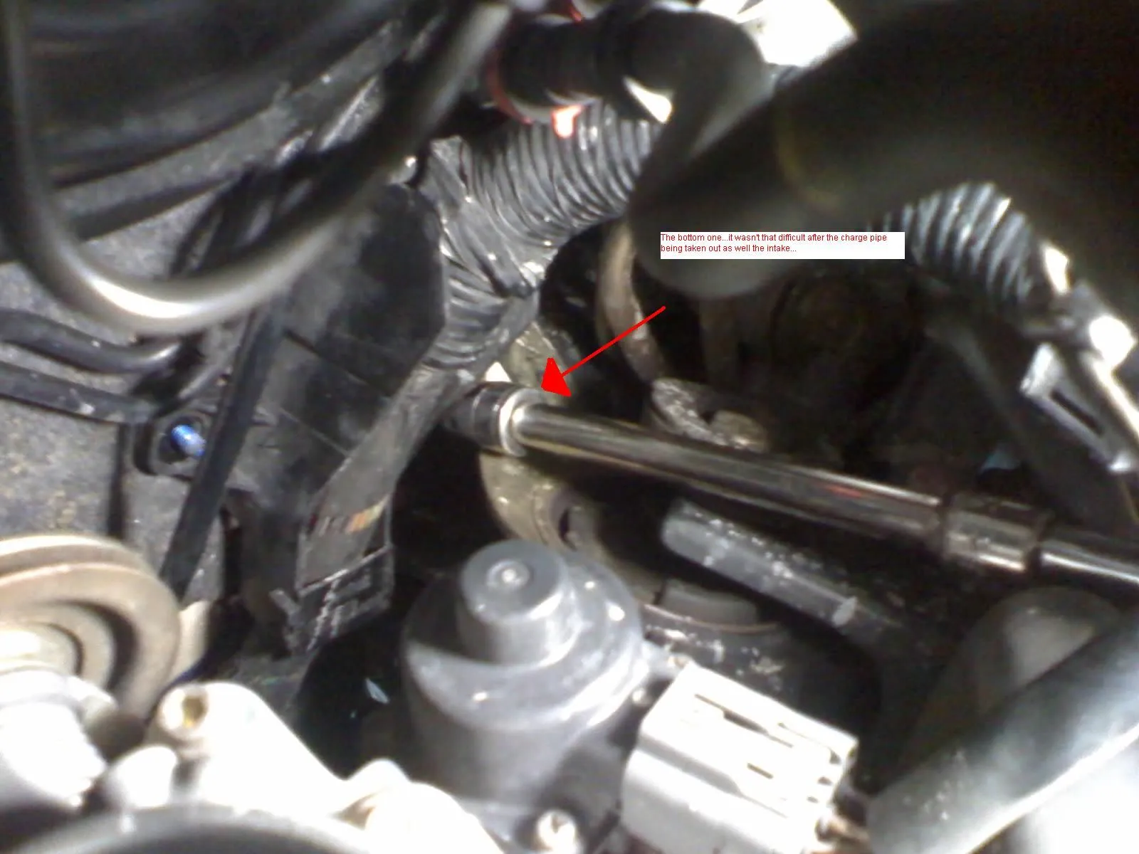

IMO,Is not that difficult if U have lots of extensions and a swivel drive(3/8) and a reducer from 1/2 to 3/8 drive so you can apply the force more easily! (I even took the center bolt for the MM,without taking the wheel out...hehehehe) With lots of extension it was easy Like 505zoom said...
But I think the bottom bolts is not that difficult, it was more difficult for me (I was alone) to leave the harness out of the way while working in the 3 botls of the MM than taking the two harness bolts out(which most poeple complainns about).

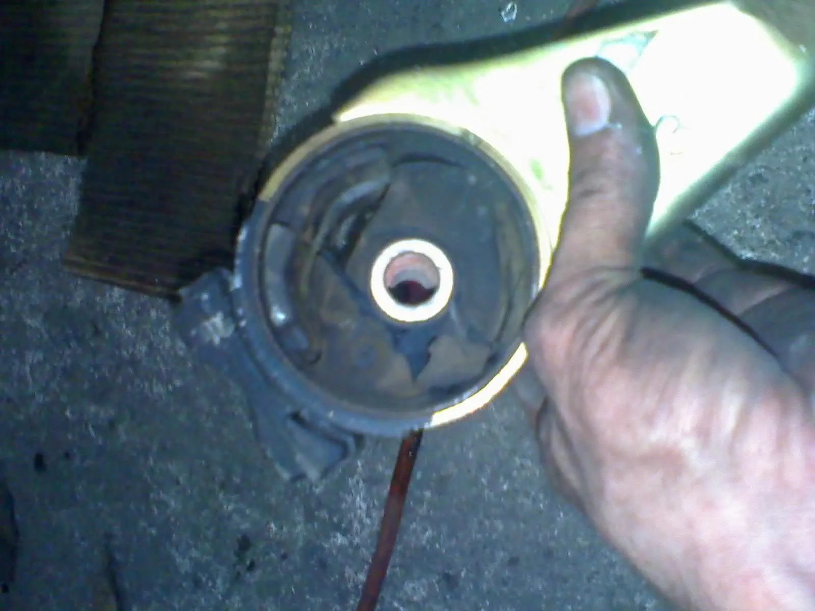

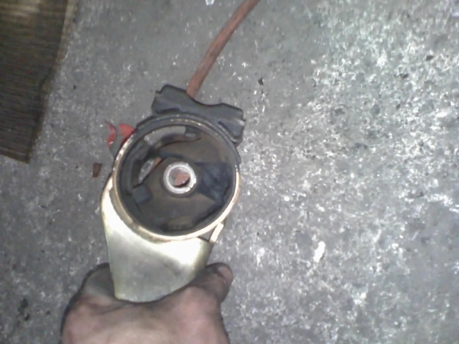

Talking about the vibrations in the engine...well look at the pictures you will notice how bad my MM's were,so in conclusion it got a little better in iddle, but when you accel. while passing the analog dial of the tach from iddle to 1,100 RPMS it rumbles very hard for that period of RPM's...but now the rear wing won't break... hahahaha

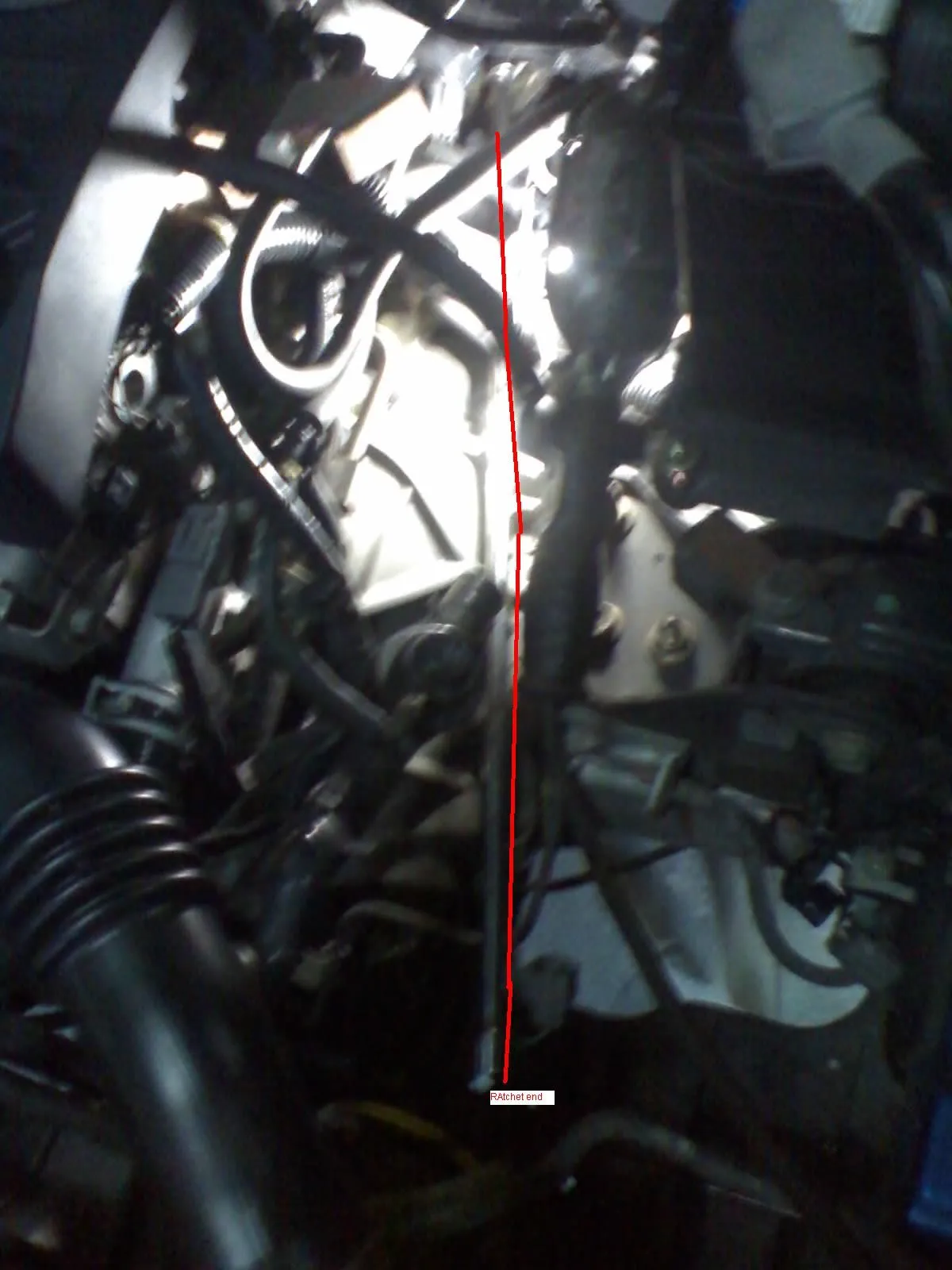

In the picture a drew a red line to show the way I went for removing the bottom bolt of the harness I took it out like in 20 secs...but i did remove the intake/bov/charge pipe/air filter/ coolant resorvoir brackets...i didn't remove the battery or the battery tray though(didn't want to turn of the music)(breakn)
