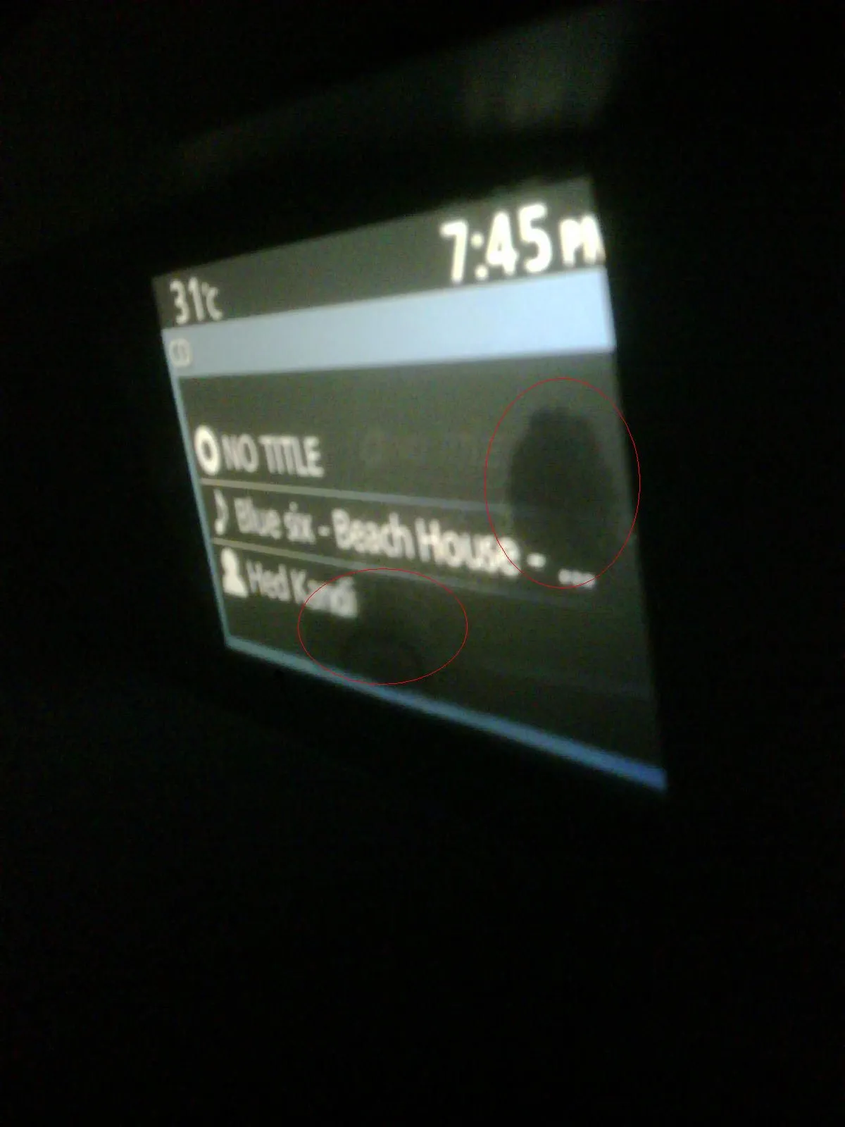

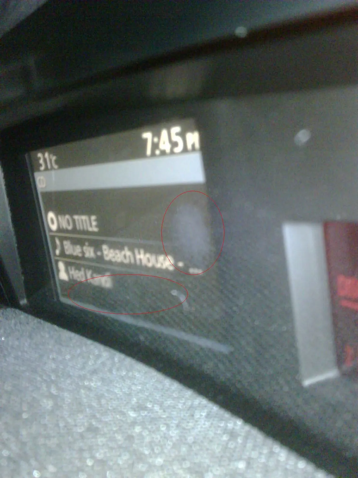

hey guys well last time i washed my car after a day or two i noticed that i got 2 big stain in the nav screen and 2 small on the redout screen i wonder what it could be from it looks like a stain of dirty water when the water evaporates and only stays the residue so i wanted to know if any body had this problem i posted some pics so u can see it and also wonder if tha plastic cover can be removed easly so i may clean it any help would be greats thanks. i dont have any warranty so the choice of the stealerfix is out ...

isn't your car new? Also are you saying you washed the inside or outside of the car? If so what did you use on the nav screen?
the car is brand new men washed the outside yeah the inside never just a dry cloth and after a day or so those stain apear inside the screen

oh men the stain got much bigger know i don't know from where is it coming i think there must be a leak in the duct of the A/C or something like thath but iam still waiting if any body can help me on getting the part out manual of the dash,
its condensation.... My gauge cluster and clock screen get WET.... like water running down them... when its a humid day... thats NOT supposed to happen. Does your windshield get wet inside?

no men not at all but i do see sometimes as u say when i turn the car off for a while in the sun and then go again and turn it on there is alot of condensation comingo from the middle two vents ofthe air but i havnt had time to check it but after new years iam gonna part off the dash of the nav screen to see what is wrong cause i have no other choice...also ur having this problem on ur new speed?? of th clock and cluster??? on humid day and when it happens doesnt leave a stain??
had it fix i took out all the dash and the tach to take the screen out very easy infact but took me three days to figure it out and cheking well every part how to take it off not to break anything got the screen cleaned and covered beneath it with a plastic cover to see if that can solve it
