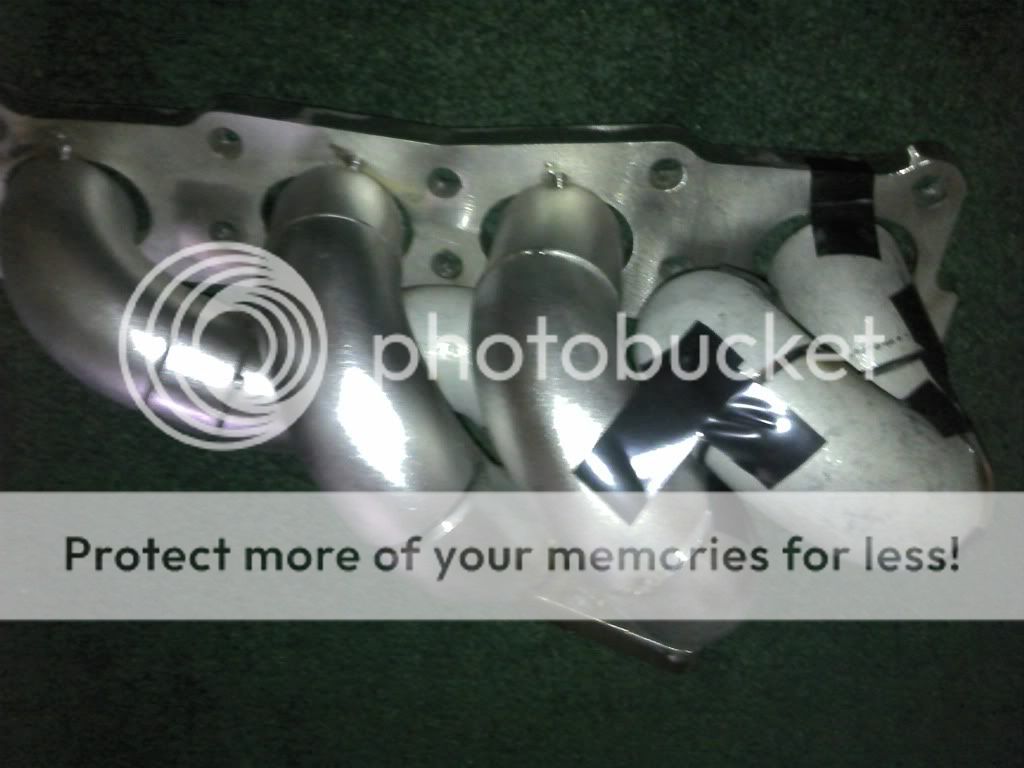

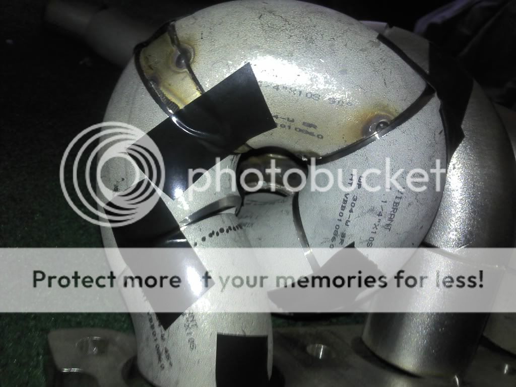

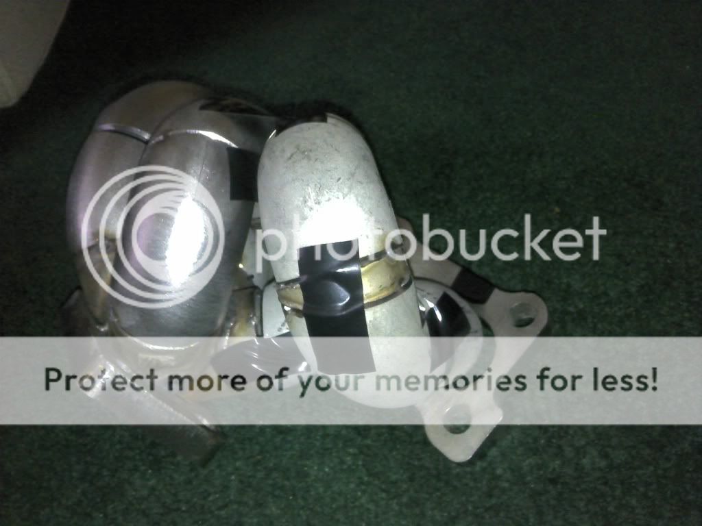

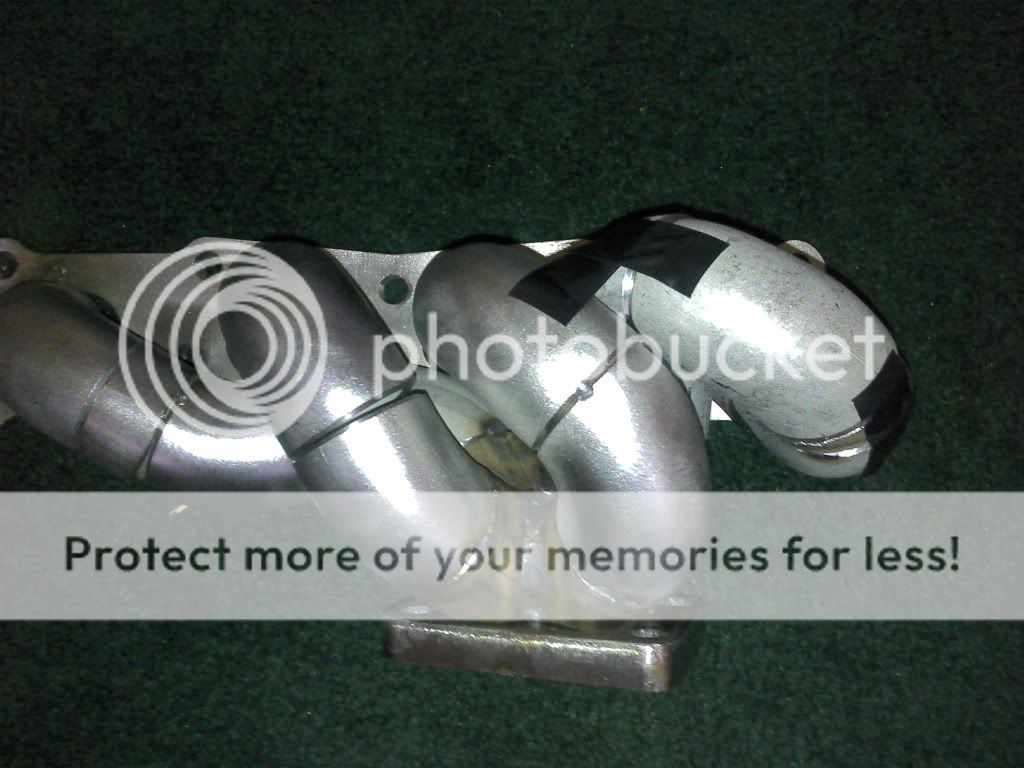

Well apparently I didn't need a couple days, just a few hours. I found a very MAM-like routing, but it isn't equal length. If anything it is worse than the short runner from that standpoint. It cannot be done in roughly 8 inches, but this looks great. You guys decide, should it be this or the short runner? Short is about 4 inches, this is closer to 15. (I've taken all measurements using the outside of the bends.)

Visually the 3rd rendition of the manifold prototypes looks the best but I think I would rather have the first prototype simply because it looks like a easier install for me ( I have bolts not studs in my current head. )
Its easy to just put in one or two studs. I'm happy to build whatever the market demands.
I don't know if I'll ever need to buy one, so I don't want to weigh in too heavily. But the less turns the better. The equal length is a nice to have, but I doubt it will have much impact compared to the energy lost by turning nearly 360 degrees. Again I stress that durability should be paramount above all other parameters.
When I build one for myself, it will get a short #4. I want as few bends as possible to keep all the energy in the manifold and going into the turbo. Plus I want mine to be as light as possible and as strong as possible. But for the general market I'm going with what buyers want. So what shall it be?
After reading what you posted about all the dynamics of how the runners are placed with how that affects the manifold. Put me down for a short #4 runner as well.
Edit: not to mention it looks a little easier to make and less materials for you. which also should yeild a faster turn around.
