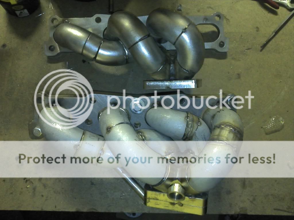

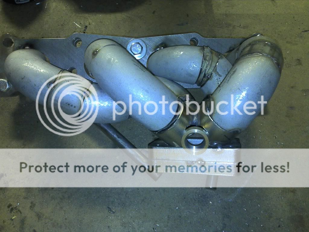

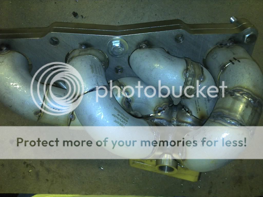

here you go :)
The prototype had runner lengths of 11.5", 8", 9", and 4". The revised routing has lengths of 11.5", 7", 6", and 8". It isn't perfect but I think its a good a can be with stock placement. I also worked the wastegate into the collector.
So the ewg will be right there on the mani? I know that sounds dumb. But I mean like no pipe off the mani to the ewg? Like to move it right off the mani? Looks good though
Haha nice. Which ewg are you gonna get stealth?
I'm looking at getting a 38mm Tail v-band (I think its a MVS but not sure) when my car is paid off. Only roughly 3 more months tell then! I might end up having to do a adaptor/placement adjustment pipe like you posted earlier. No idea wtf that this is called. When I get the manifold and EWG installed. I plan on getting the turbo clocked and my hot pipe redone.
lol it definitely looks interesting now.
Not 100% sure if I like the looks of the new routing to be honest but I want to wait and see how he manages the EWG portion to really comment to much.
