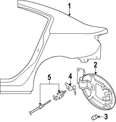

Yes, I actually started to drive away with the gas hose still in. The hose pulled out and broke the locking pin that is operated by the cable by the front driver's seat lever.
Does anyone have info or part number to replace it?
Any help appreciated.
landru
B09556890F - Is it #5 in the diagram below (it's of a Mazda3 but they share many parts)? If that's the part, it's $30.72 on ebay - CLICKY.
And another that's used ($17.99) off a CX-7 but with the same part # - CLICKY.
