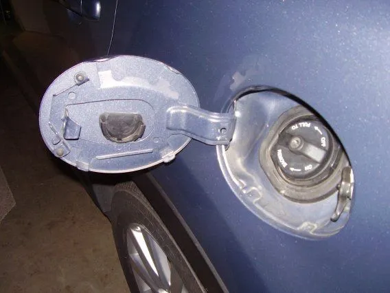

This topic is funny. I intentionally destroyed my plastic teather and replaced it with a black piece of dacron fishing line. The stupid teather keeps you from being able to properly stow the cap. I used to have to wedge it in between the locking tab on the door. Oh, BTW I also attached a stick-on magnet to the cap so I can stick it anywhere while fueling.
Had I not goteen a locking cap, I was going to take a short piece of coated cable and crimp it onto the trimmed ends of the cap and anchor. I did this instead...
