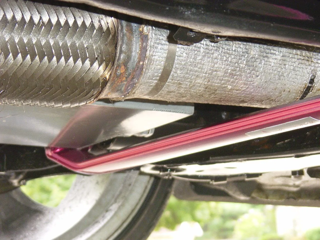

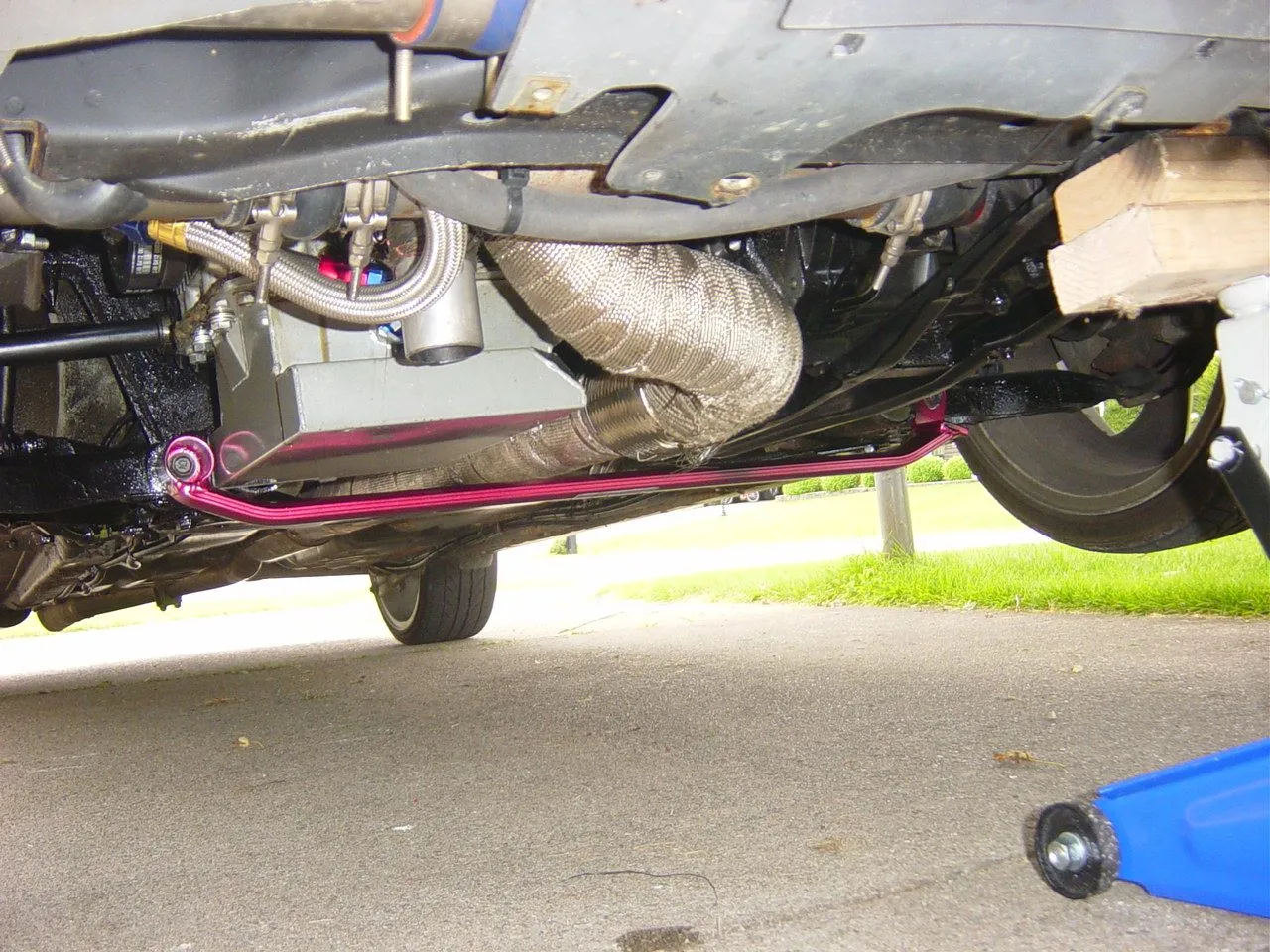

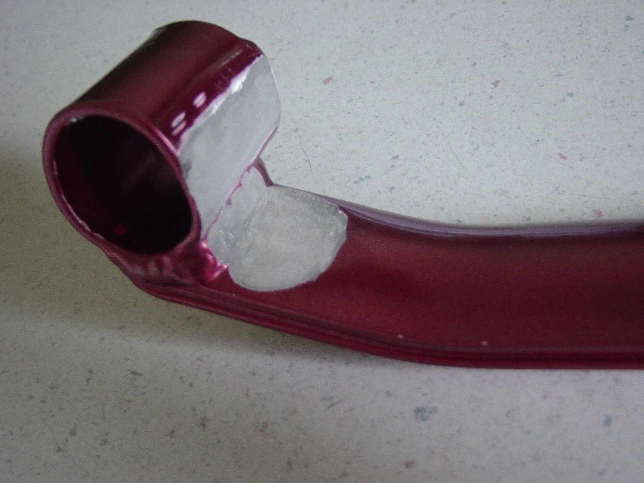

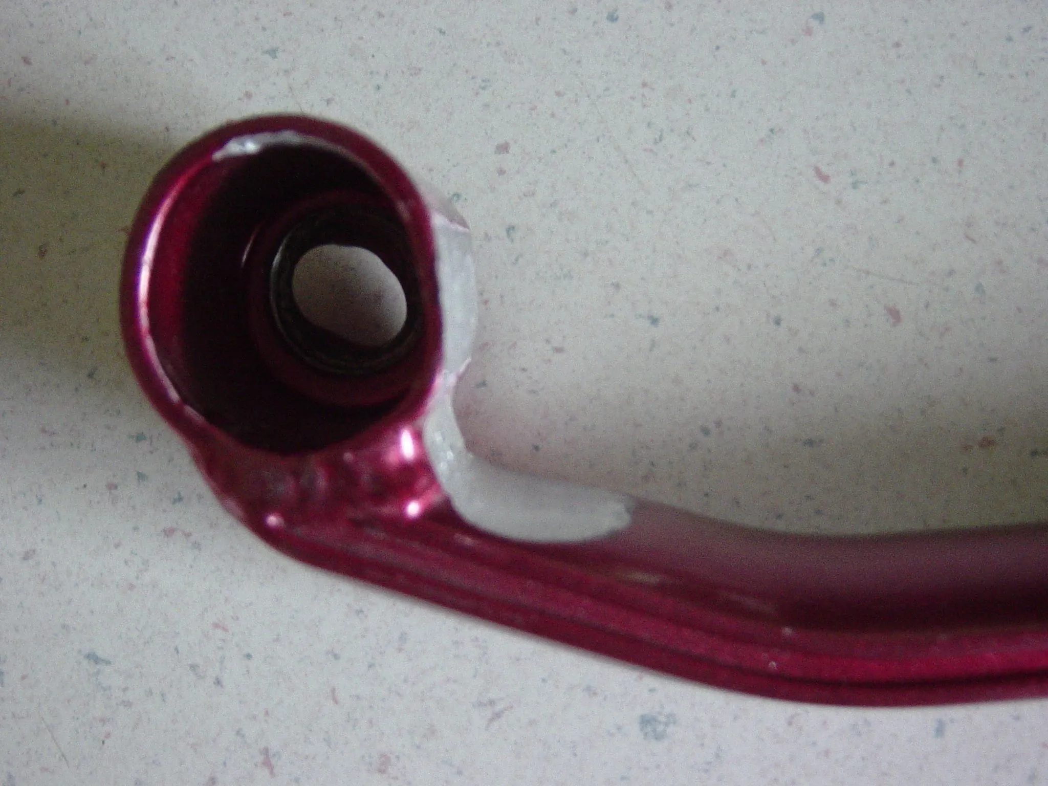

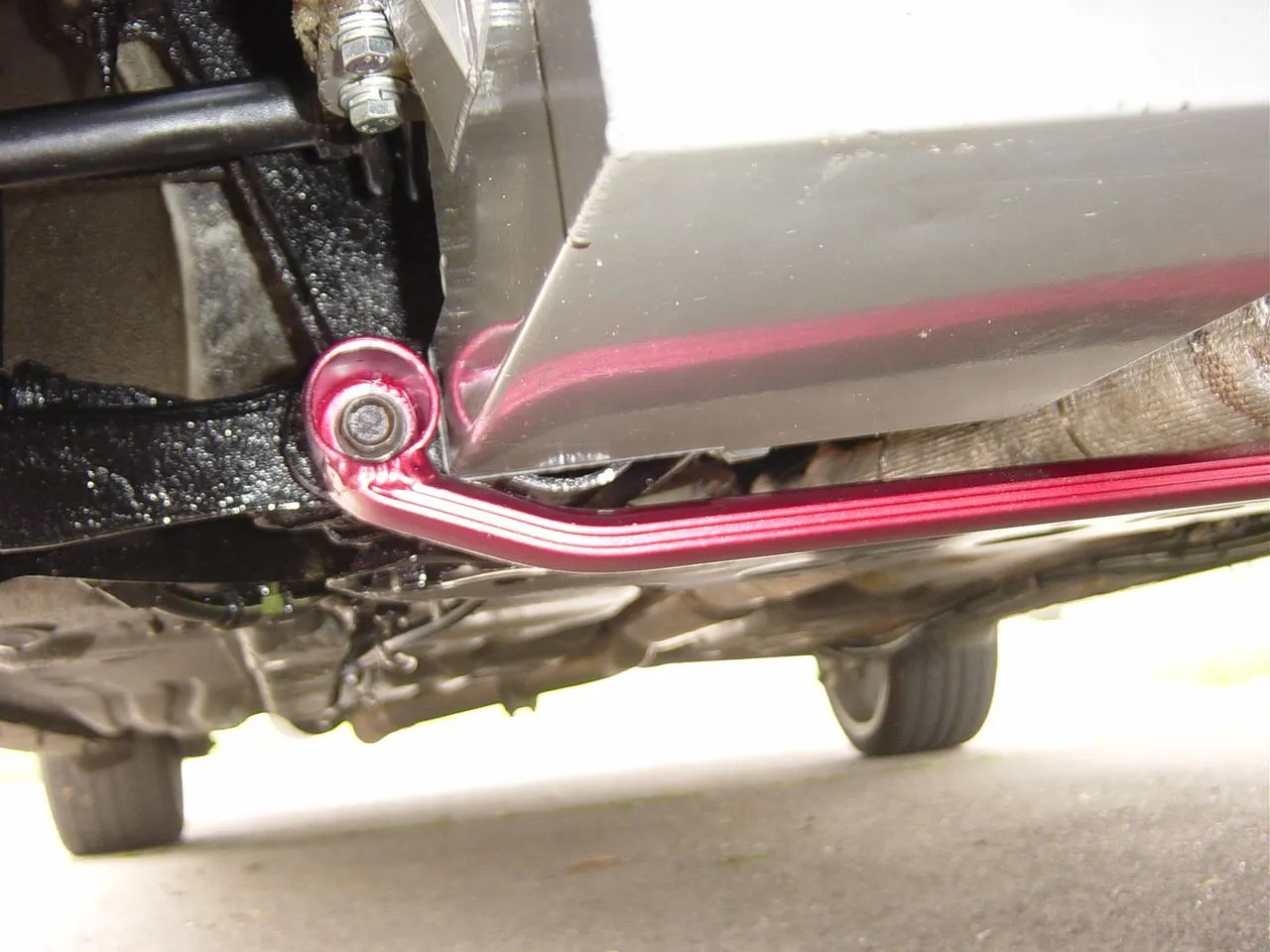

There will have to be a very small amount of modification tho. BUT, all u need is a hammer and optionally a grinder. The pictures of what needs to be done is in the thread too. But basically just do this:
1) install the bar as is
2) mark where it just barely hits with a marker
3) remove the bar
4) give it a few taps with the hammer in the spots marked
5) grind it smooth if you want, just dont go too deep
6 reinstall the bar and make sure it fits. if not, go back to step 2
THATS IT!!! So problem solved. Now go buy his other stuff while you're at it. Cheap prices and a great guy to deal with.
I will have more photos of the finished product installed later. I painted it gloss black, so I have to wait for it to dry. The first 3 photos show how it fits when I first got it. The last 2 photos obviously just show how i modified it.
