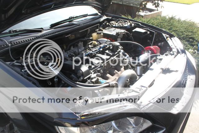

Here's a update on the current photo of the engine bay.

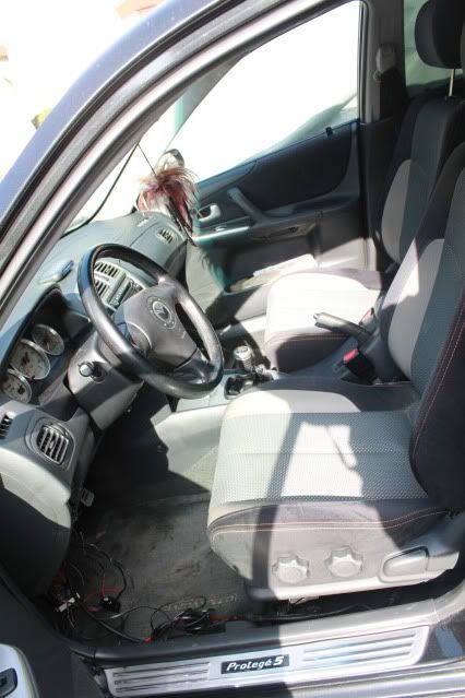

I got the whole Mazdaspeed interior swapped inside. Looks great! (front/rear seats, MSP shift knob, MSP cluster, all pedals w/ sparco covers and Mazdaspeed floor mats)

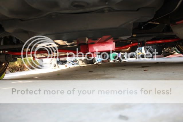

Update of what the current underside looks like. Installed the rear Racing Beat Sway bar with upgraded urethane bushings and AWR adjustable rear endlinks, KMR Rear V-Brace and with the lateral arms.

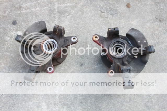

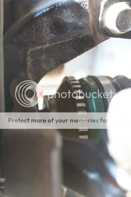

Pictures of the old knuckles. Since the cluster doesn't work and the problem is linked to me not having ABS. I had to take off the whole ABS system from the MSP and swap it over. (the whole system would include the whole ABS device, the front sensors and also the MSP knuckles because my P5 knuckles don't have the holes for the sensors.
MSP knuckle installed and showing the holes needed for the sensors.

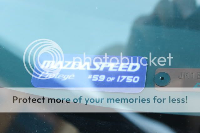

Last,but not least. The official badge of the production badge from BadBander's MSP. I wanted to take the badge and add it to my P5 and show BadBander's legacy will always live on! Hopefully you'll see this Raj! haha
