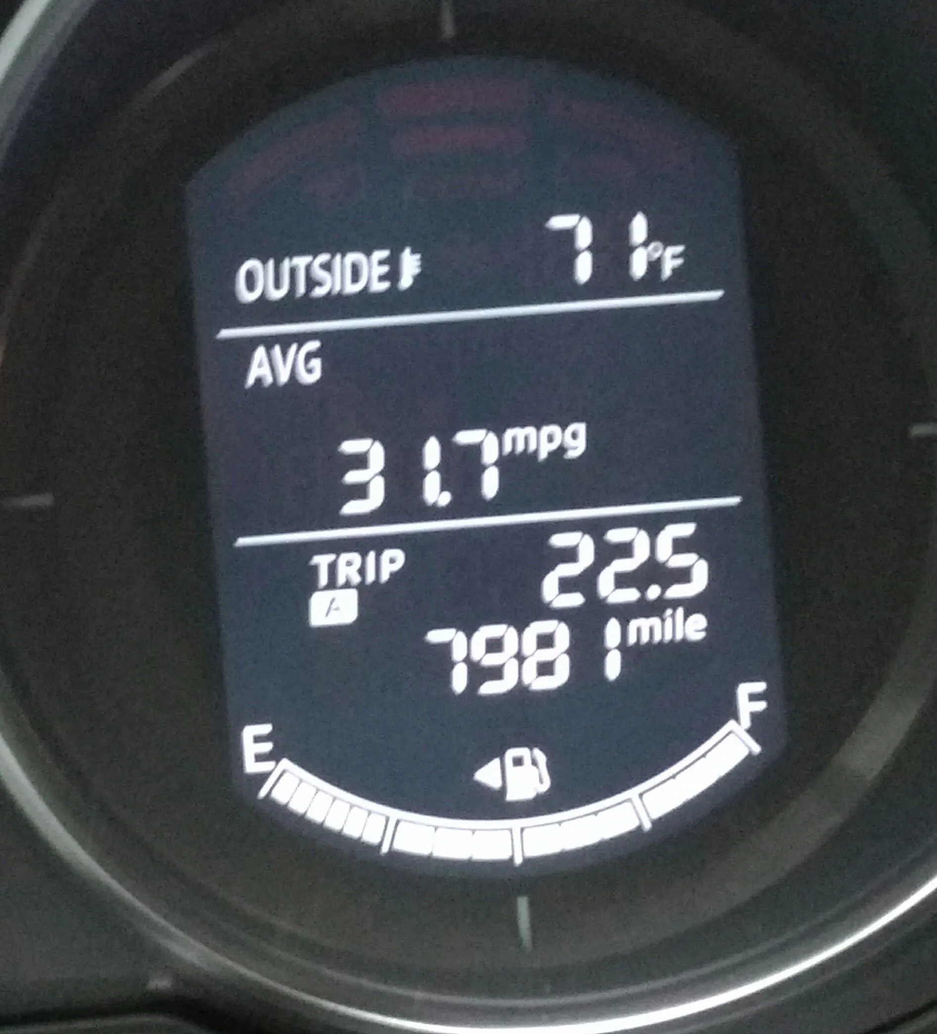

Super economy - my mpg for a single day : drive 7 miles city 45 mph - it has 14-15 lights with 50% chance of a light, highway is all lane shifts followed by 65-70 mile bursts. Add a small detour to drop kiddo.
I think I will have to set the bar at 30 or 31. Thats really good for so many stop starts and some super acceleration. This is better than competition by 2-3 mpg atleast.
I have a stock Touring with Bose. No mods or any weight reduction.
