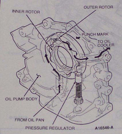

would you extend the service to include the Mazda KL v6 Oil Pump (KL0114100J)
The Mazda KL V6 oil pump is of the same general design as that used on the FSDE eg 9 toothed rotor running in a 10 lobe outer (Part number KL0114100J).
The PRV and oil flow arrangement is the same as far as I can establish.
It also has the same lousy reputation as a contributor to early engine failure, once performance modifications (and increased maximum engine revs) are applied,

Yes, we have done pumps for several different motors since most of them have similar shortcomings. If you would like to send it to us we would be happy to look at it to make sure we can service it and quote a price. PM me and I will give you the details.
