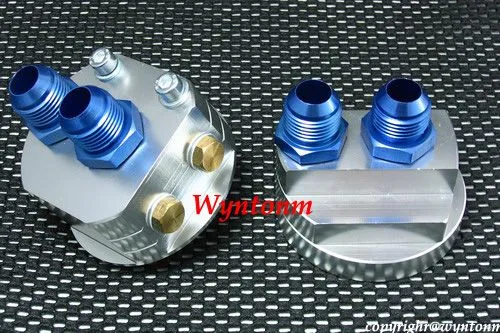

Here is the system I am putting in when MP3 Racer gets the pump and regulator back to me. Might be overkill... lol
