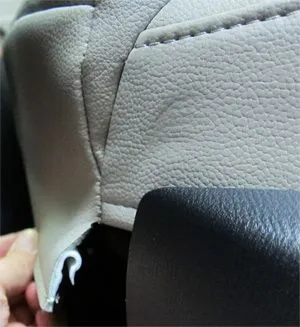

The front part of the bottom seat leather has come loose. It has plastic clips. Two about 4 inches long but I can't see what or how they hook.
attachment.php
it seems like a stupid way to attach it.
from the indents in the plastic clip it looks like they had it on just the thin metal rail that goes around the edge of the power drivers seat (on the passenger seat the leather/vinyl attaches completely differently) and that is why it just popped back off.

Did we ever figure out where these damn clips go? Getting in the car I noticed the front part of my driver seat just hanging, I'm like wtf?! then I see these two white clips just dangling as ta240 mentions. I went underneath to see where the heck they could clip to but I give up. I need to take pictures as the clips don't really align with anything underneath the seat. If anyone has had this issue and resolved it please let me know.
I can try to take a picture tonight (don't have the car here), not sure how good I'd be able to do under there but I took it like pictured and then basically fold it up under the seat with it pivoting at the hook part. The plastic hook then grabs the metal edge to slide over it a bit and then folds up under so that the longer flat side of the plastic is against the seat and the vinyl is facing towards the rear of the vehicle.
the plastic is too wide for where it is grabbing on mine which is what seems to push it back off. I've thought of cutting it a little narrower but didn't want to mess with it for fear of Mazda not being willing to do anything at a later date if it didn't work.
It would keep popping out every couple of minutes so I took some cardboard and folded it over to make it thicker and stronger and wedged it into the seat metal so it held the clip from flapping back around. After awhile the cardboard fell out but the clip stays better now.

Essentially the clips on the leather are 40mm misaligned with the anchor rods on the seat sub-frame. If you re-clip them (as my original Mazda dealer did before I gave them the flick), they will break free a day or two later. Truth is, I engineered my own fix, I had to cut a slit in the plastic clips to correctly position them on the anchor rods...not pretty..but it has lasted successfully for 5 months and shows no signs of coming free.
