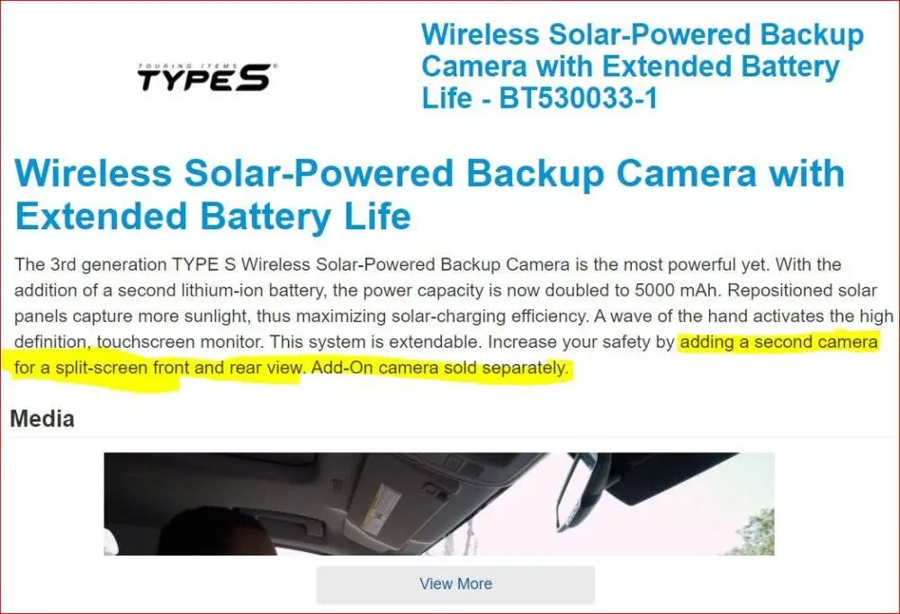

This isn't exactly what OP is looking for, but could be an easier option.
Costco sells "Type-S Solar Powered WIRELESS back-up camera. You can add another one at front, have split view wireless monitor. I had installed a back-up camera on older Cayenne, the wireless monitor works well.
