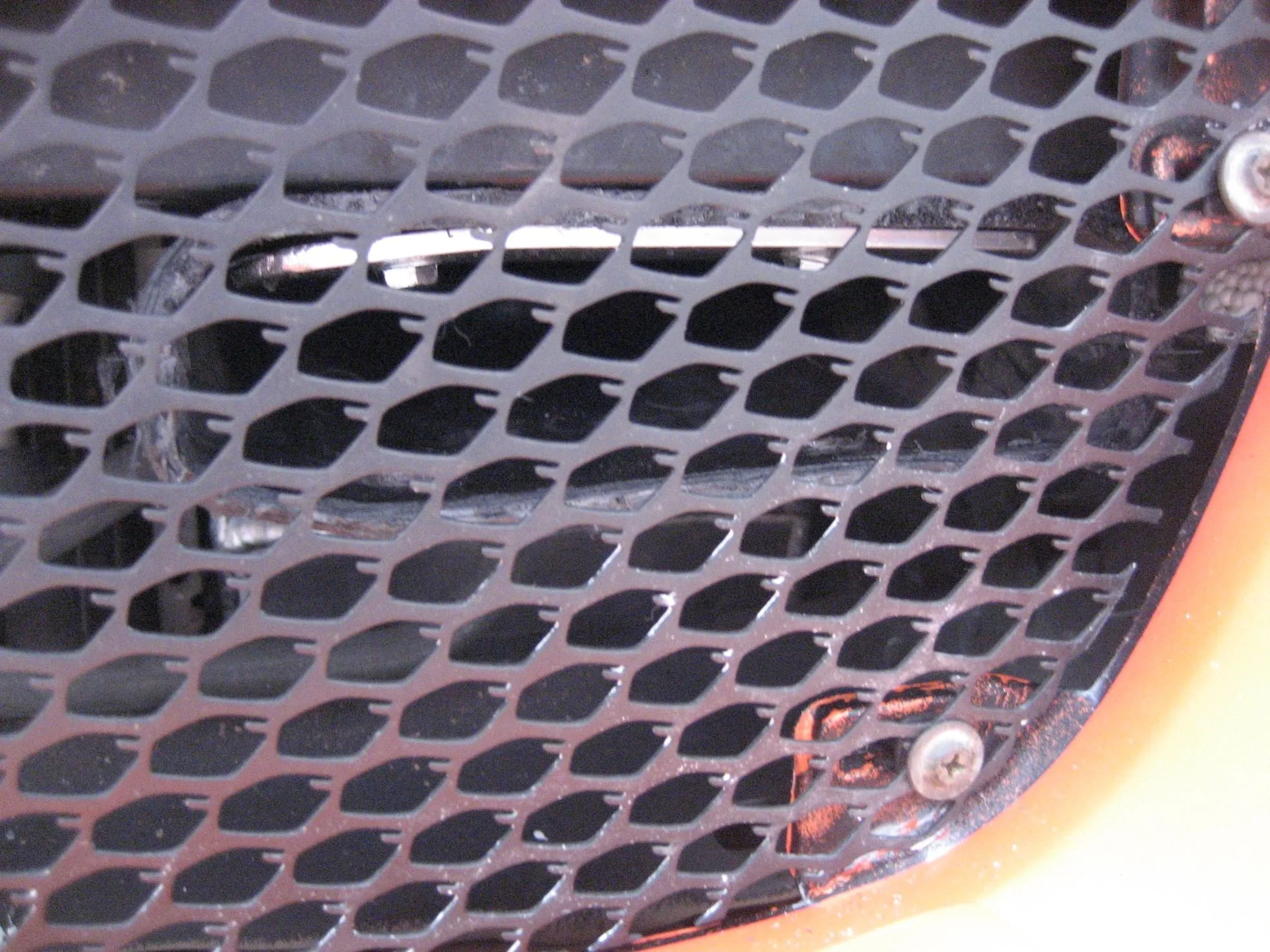

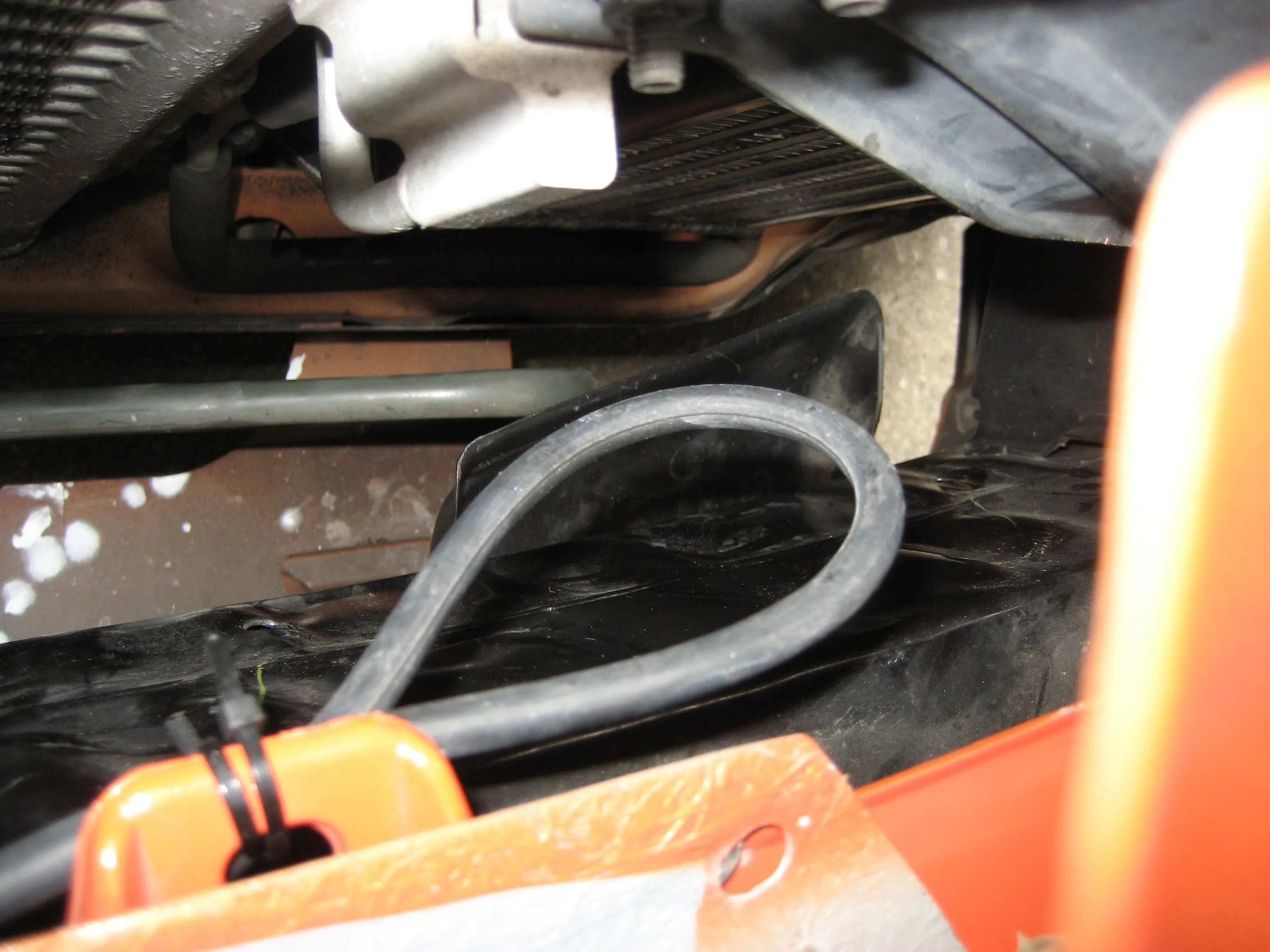

ok so I just wanted to say that I actually did it finally, First Ever I believe... it isn't much, and it wasn't as much as I was thinking in the first place, but it works actually pretty well, considering that I took it off my brother's old Mercedes air vent
I have some pics, I forgot to take pics before I put the pieces back on, but you get the idea.. and I still plan to do the DIY IC sprayer, once I can find some spray nozzle home depot and Loews both don't carry irrigation stuff anymore which sucks.. so I gotta find them online, you can see the vent behind the IC sprayer hose (windshield washer tube)

that looks good hopefully it doesnt rattle to much
ya me to, I tightened the screws in there pretty good (self tapping screws, one went in a little crooked but is still tight) and I placed that metal bracket there to support the plastic, and the plastic is semi thick already, so should be good, I will check it once I do some highway driving to see if it loosens up, but I think it should be good

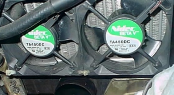

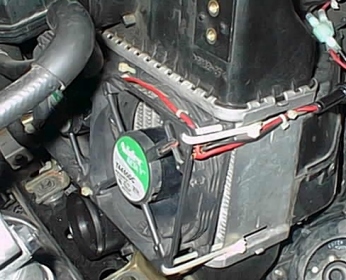

i was thinking of doing something like this..
if anyone here knows anything about computers you will know A: these fans are 12 volt and B: you can get some that reeeeaallllly crank out some wicked air.
these dual fans will pump out enough air to cool the intercooler without a doubt.
if I do it I will post up a DIY
edit:
hahaha check out this bad boy -> http://www.tigerdirect.ca/applications/searchtools/item-details.asp?EdpNo=1701168&csid=_21
well the fans im looking at are around 89CFM each.. so two is close to 200CFM but yes i will definitely do a write up soon
how are they resistant to water?.. or could they not get wet at all, like in rain?
I could still use one of those probably on the top section of the SMIC, and just keep the normal air ram thing in the bottom half.. would be sweet, I also installed my DIY IC sprayer yesterday, just have to adjust it today
i thought of that yesterday. the wires are shielded and the bearings are sealed inside the fan head itself so i don't see water posing a big problem IMO.
