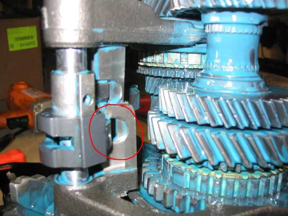

just get tri point to make gusseted shift forks and you should be god, like I did :)

tripoint will take stock mazda shift forks and re-weld them by gusseting them (think of it as adding a strut bar, or bracing, to make it stronger). It cost me 100 for alll the shift forks, 1, 2,3,4, no reverse, no fifth gear. Costs 200 labor, 100 parts, tada. Took them about 3 days from order to finished, but they had the parts in stock. Tada, no problems, and it's the same thing they put in their world challenge proteges on speedvision. Just talk to Mark, he's the man :)
the forks all break on the actuator arm. There is a notch that allows one of the collars in the tranny to turn side to side inside of that arm on the fork, and then it also pushes the fork up and down on that arm. That's the weak point as it is rather thin there. By adding some material wherever they can, they can make it stronger and hopefully eliminate the breakage.
See what I circled in the picture.
If you fill that in with metal and remachine it and do something to reduce the severity of those notches (the small radiuses of the corners in that gap on the inside) will vastly improve the reliabilty of this part.
That and contrary to what I saw posted by someone in some thread on here a couple days ago... Gears are NOT meant to be slammed... So shifting light and rpm matching on the fall go a long way to protecting you from snapping that part. Keep in mind the thickness of that part is only about 1/8"-3/16" and you can get some serious forces in that tranny.... so pretty hard for it to hang on!
