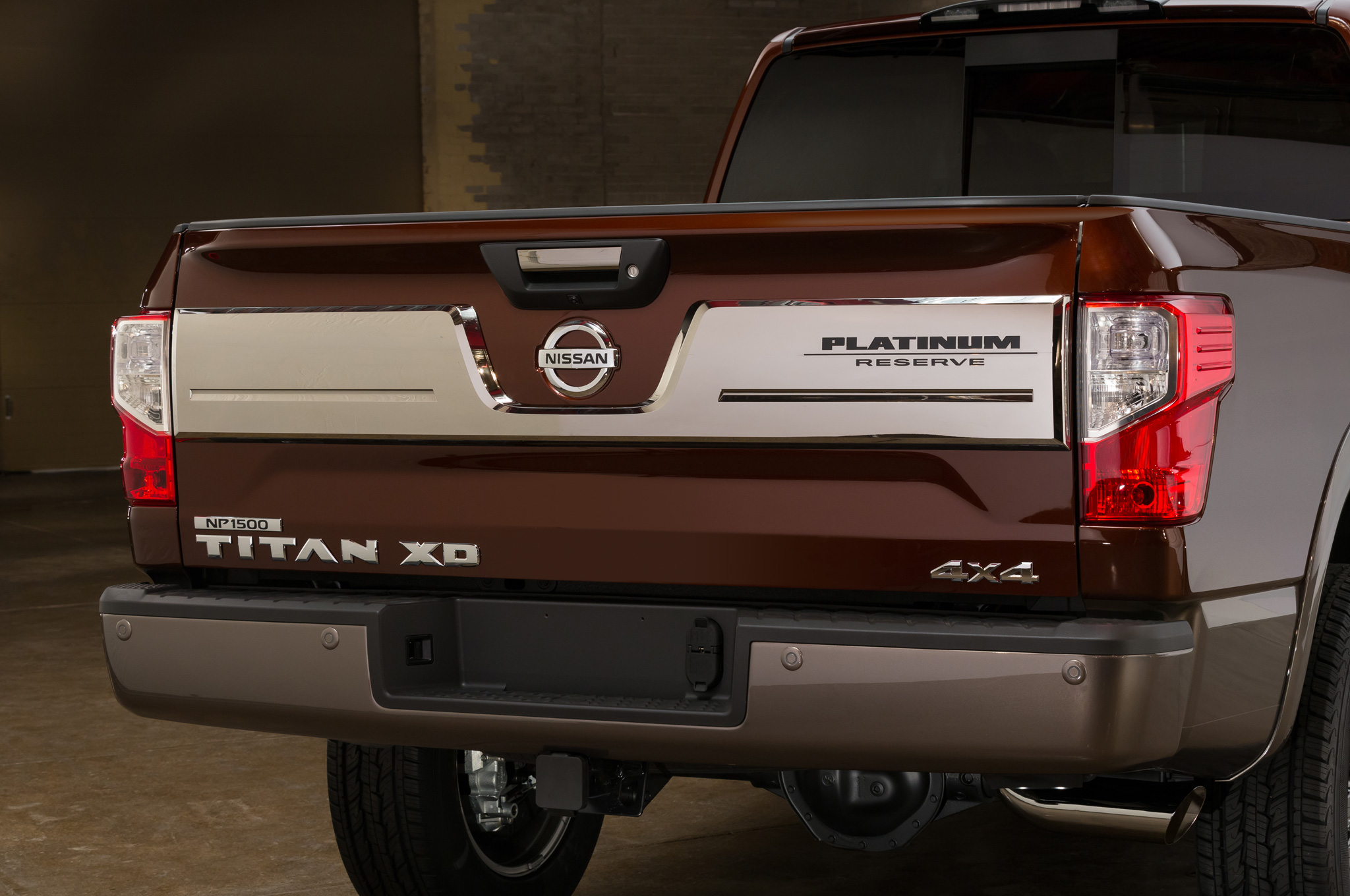

Why is there so much written on the back of this truck (OEM) looks tacky imo.
