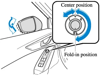

Could it be because your mirror switch is in the folding position?
“To fold, rotate the outside mirror switch.To return the mirror to the driving position, rotate the switch to the center position.”
Hello youri, thanks for your thoughts on this but no; the switch is in the correct position and not the fold in mode.
