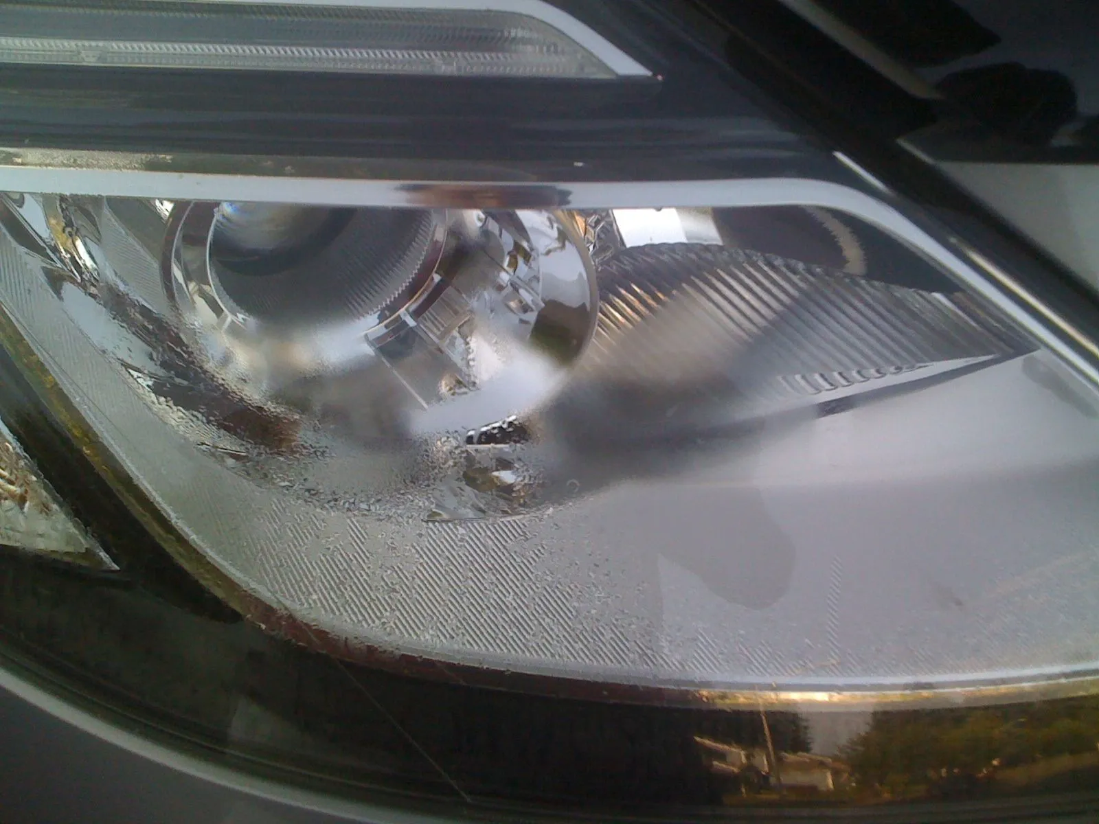

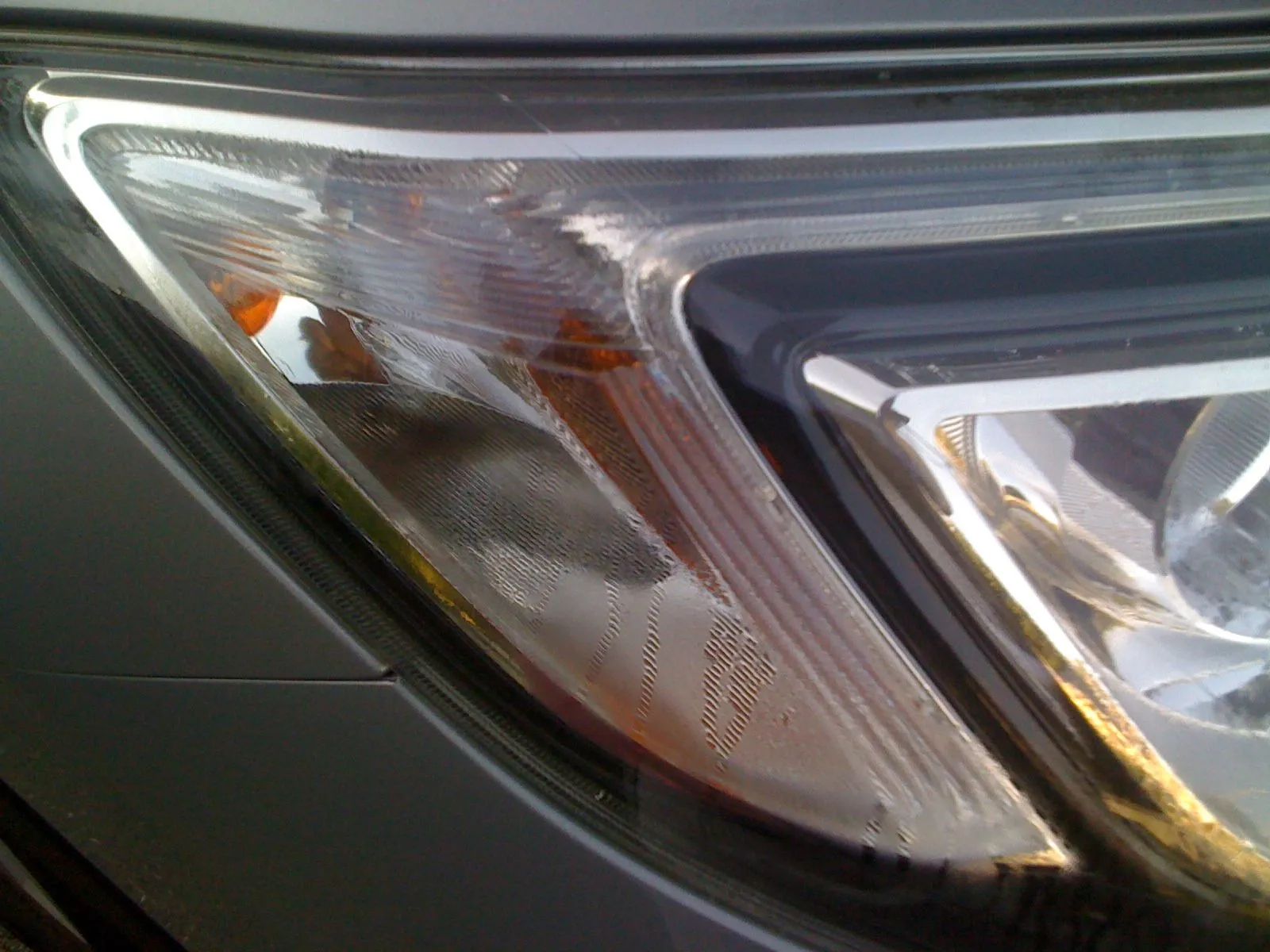

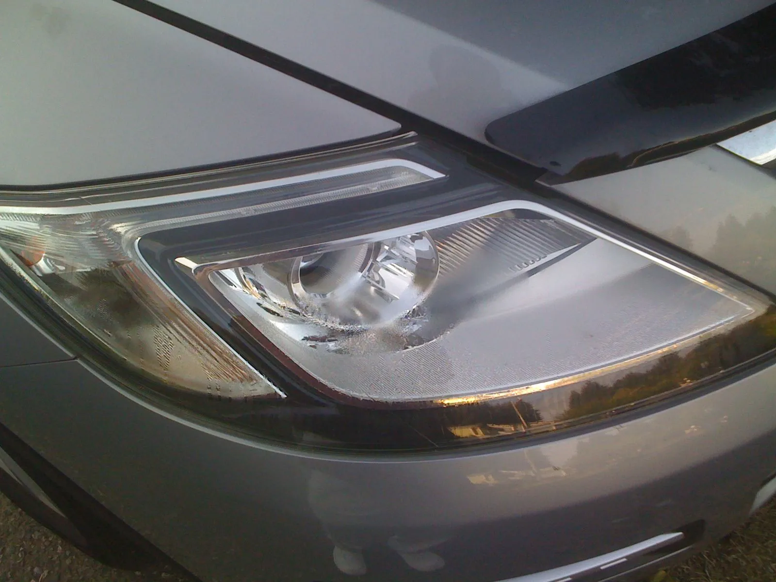

I just drove to touchless car wash today. After one hour, my CX-9 right (passenger) side headlight assembly has foggy/moisture inside.
I want to ask you if deal will replace whole assembly or repair it?
Thank you.

I probably wouldn't worry about it just yet. That happens to my taillights when I wash the 9, and the moisture dissipates shortly thereafter.
However, this is the first time it happens.
My CX-9 is over 2 years and this was never happened before.
I have talked to dealer and they are getting approval to order me a new housing.
I had couple snow times here in northwest washington and no condensation at all.

My understanding of the headlight housing is that it is not air-tight, but condensation like that indicates some crack in the housing. My old BMW had a cracked housing, it had condensation like that in the photos. There was none when new even after washing.

I don't know about headlight, but it just happened for the first time in over 2 years, and to passenger side. I don't even see any cracks or chip. That's why they confirmed there's something wrong and ordered the replacement.

Actually, when I got into dealer to show them the condensation, it was almost gone. I let them see this page. Fortunately, when I got home, it was condensed again, so I went back to dealer and they confirmed it.

Most headlights have a little Goretex patch that lets the headlamp breathe (i.e. keeps water from coming in, but lets moisture come out). Are you sure you didn't damage that patch? Might be the easiest fix if that's the issue...
