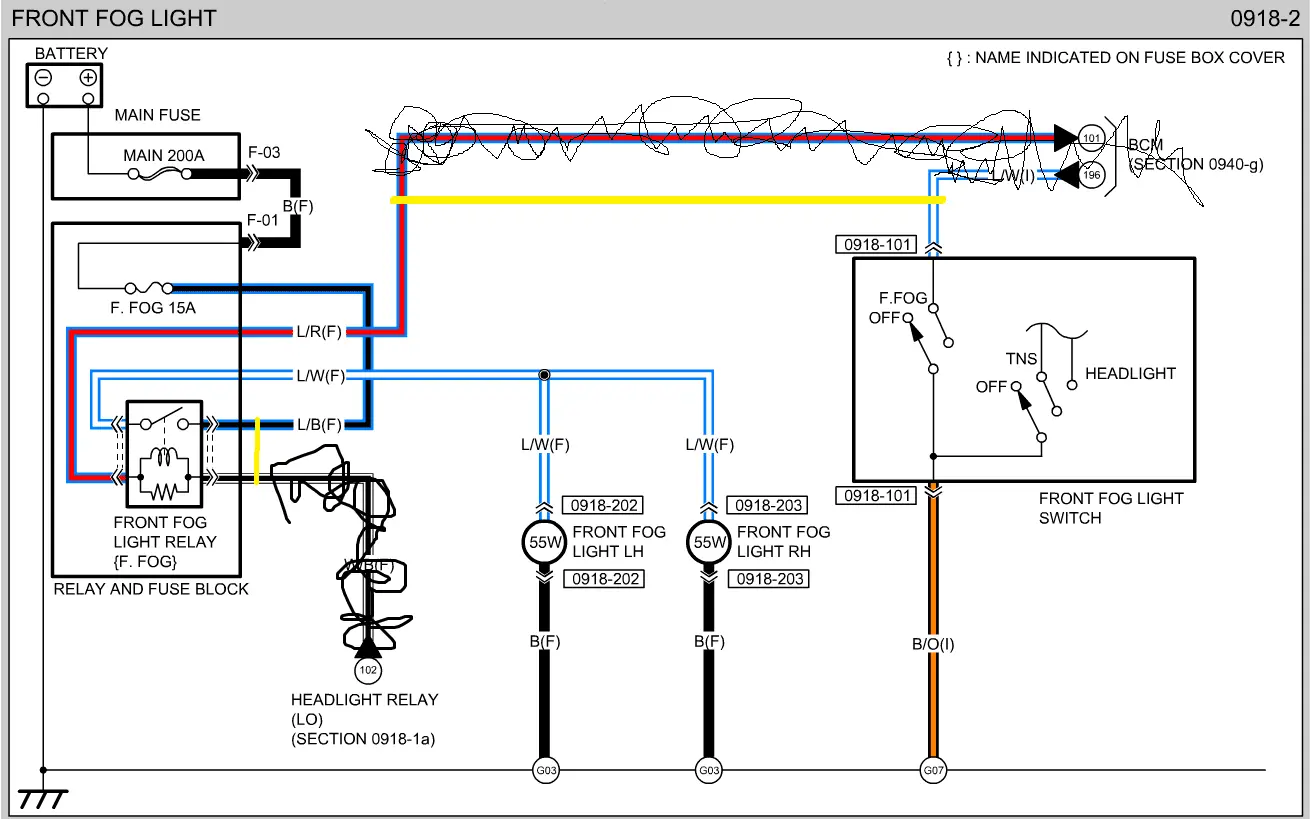

Alright guys, well I tried wiring it at the engine fuse box, and feeding the fog light relay to the taillight power instead of drawing power from the headlight switch. Unfortunately looking at some schematics, the foglight and headlight go through the BCM. Therefore, I need to do a little more under the dash to find the correct harness and wires for this. Unfortunately no time to do that considering I am leaving for New York tomorrow for the Orange County Choppers Mazda Meet. I will hope right back into that some point next week or next weekend hopefully. If there are others that are pretty decent at hunting that stuff down im going to link a page that has multiple pages of the mazda2 BCM wiring.

Okay, after poking around the diagrams at mazdaserviceinfo.com, I think I might have an idea how to do it, though I won't get a chance to try it out until this weekend at the earliest. If you look at the F-02 fuse box under the dash:
http://am.mazdaserviceinfo.com/emaz...013/Mazda2/m2/books/m2d09/html/conn/F_02.html
Fuse F22 there (METER 10A) is powered only when the ignition is in the on or start positions. Then look at the fog light diagram:
http://am.mazdaserviceinfo.com/emaz...M/2013/Mazda2/m2/books/m2d09/html/0918_2.html

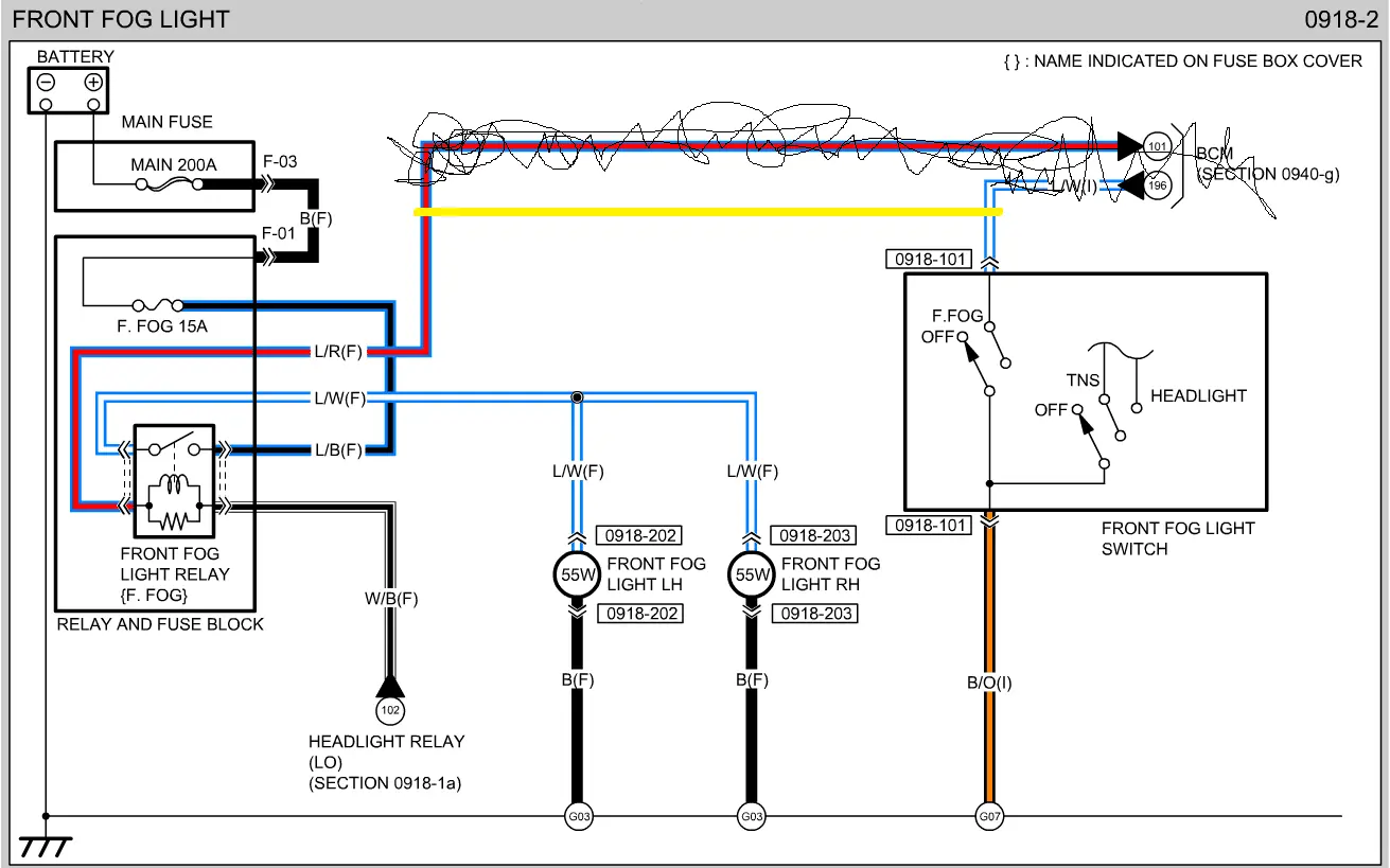

The front fog light relay (R7 in the main fuse box) only opens when receiving a signal from the BCM and one from the headlight relay. If instead of taking a signal from the headlight relay it took its signal from fuse F22, then the fog lights should be on when the ignition is in the on position and the fog light switch is on. Thus, DRL's, right? Somebody more familiar with this will have to check my work, but if nobody else is able I'll start poling around my fuse boxes to see if I can figure this out when I have the chance.
You can try, the main thing looks like you have to bypass the BCM, I was thinking cutting these two wires and having a jumper wire from one to the other, just to locate those two wires
I would like to try it without bypassing the BCM first, but you may be right and we may need to do that, too. I'm sure you'll have to bypass the headlight relay, though. See attached.

Yea, I saw that....all around the 2 looks like a huge problem in this foglight headlight tie in.....I already tried drawing power from the taillights to power the relay, and could not get it to work, in fact it powered the headlights as soon as i turned on the driving lights.
