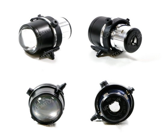

Ive been thinking about getting these. According to the below, they are direct fit.
http://www.ebay.com/itm/Direct-Fit-Projector-Fog-Lamps-For-Mazda-3-5-6-MX-5-CX-7-HID-Lights-Compatible/381471461154?_trksid=p2045573.c100034.m2102&_trkparms=aid%3D111001%26algo%3DREC.SEED%26ao%3D1%26asc%3D20160824094423%26meid%3Deecbe20c1bd54f4aa6e4c70373fa6a27%26pid%3D100034%26rk%3D5%26rkt%3D8%26sd%3D222243873222

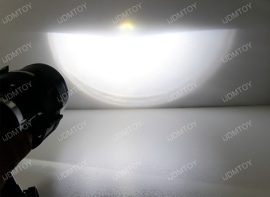

This page features a newly designed HID compatible projector lens fog lights that are perfect for enthusiasts who want to upgrade their halogen fog lights to HID with a good beam pattern like OEM projector headlights! These 2.5" projector fog lights are finely crafted with an optical glass projector with a metal case, so that it's the perfect candidate for people who want to install HID with a sharp cut-off line.
Other lamps on the market are made with plastic so they can only use halogen. These iJDMTOY projector fog lights are suitable as an HID-ready application so you can get that crisp HID look. Since the main purpose of these projector fog lamps is to install with HID, there is no bulb included.
This set of HID-ready projector fog lights is compatible with the following Mazda to replace its original fog lamps:

Projector fog lights with H11 HID compatible design
2.5 inch size, DOT SAE compliant with finely crafted optical glass projector and metal case so it's great for people who intend to upgrade their fog lights to HID with cut off line
Replace OEM Part Numbers MA2592108 MA2593108 LE45-51-690C LE46-51-680C
Since the purpose of this application is to install with HID, there is no bulb included
