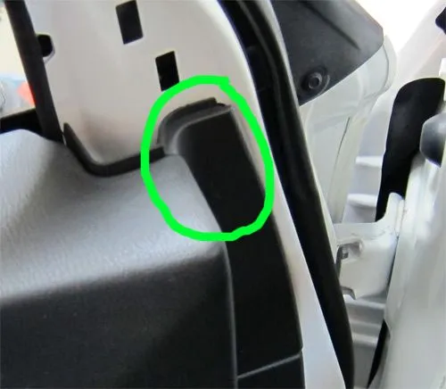

I'd had a noise that was getting more and more common and noticeable. It came from both sides and sound like it was coming from the dash or lower a-pillar. It was still intermittent enough that I figured it wouldn't do it if I took it to the dealer. After a lot of listening and pressing on different areas when it would make the noise I narrowed it down to this area:
I thought originally it was the little plastic insert inside the door latch cup but after removing it and pulling on the plastic at the front it still made the noise.

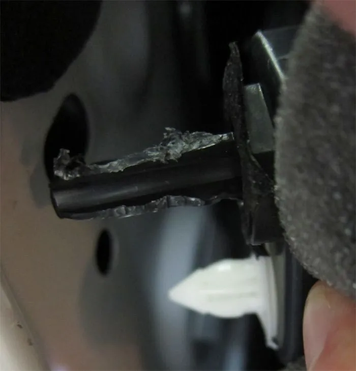

After some more looking and listening I found the black guide pin just below the white plastic clip. It has a really thin felt like material on it and it had slid a bit off to the side and my guess was the exposed plastic would hit the metal door and make the click sound.
I added some cloth tape and that eliminated the noise.
On the passenger side the plastic clip stayed in the metal part of the door and when I got it loose it fell down inside the door panel. Then as I popped more of them loose trying to get at that one they all stayed stuck in the door and broke apart as I was trying to get them out so now I need a few new clips...
