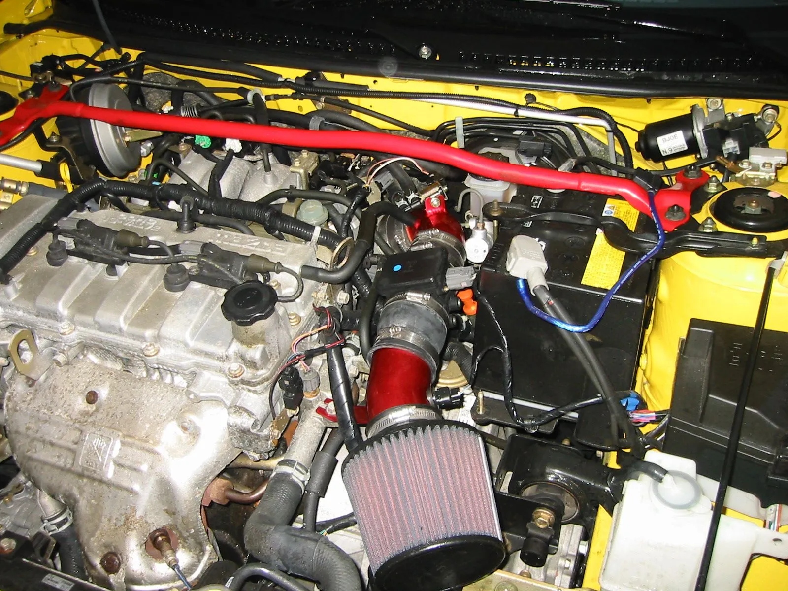

i installed my AEM intake yesterday too....
but can't hear anything different from the stock one at all...
anyone have any idea why?

yea i think i installed it right..
does this looks right?
It looks right to me. But yoru intake is completely different than the one I got from AEM. WHen you go "pedal to the metal" it doesn't sound different at all?

yea it sound the same :(
but yea.. mine is the auto version..

Mine's manual. I'm a bit of a noob with cars, but maybe that's the reason... Anyway your install looks right to me!
