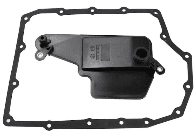

Could not find OE ones, but here is an aftermarket kit (filters and gasket).
Yeah Mazda has never offered any “kit” for ATF change. And Mazda doesn’t even use any ATF pan gasket. In addition, if anyone thinking about using the aftermarket transmission filter with pan gasket, be aware that the gasket may not fit depending on your transmission pan. Mazda had changed the transmission pan shape when they added the cylinder deactivation for 2018 CX-5, where the transmission was also modified to add some components to fight the vibration by cylinder deactivation. Hence for 2018 CX-5 or newer using the RTV for the ATF pan could be the only option at this time.
