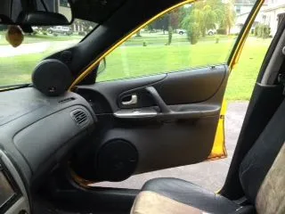

So this project has been roughly 8 years in the making. I finally rebuilt the doors to hold some JL ZR8 woofers. To do this, I had to first move the door speakers, so I rebuilt the a pillars to hold Focal 5 1/4" polyglass components. The sub in the headliner was built about 6 years ago and can be found here
http://www.mazdas247.com/forum/showthread.php?123742658-Sub-Box-Finally-Done!&highlight= I currently have a JL 12 tw3 in there. The whole system is run off a JL XD700/5 using the 3 way crossover option. Literally 2 weeks after finishing the doors, I bought a 2011 GTI. The p5 has since been downgraded to winterbeater :( trying to decide if I want to sell the system out of it or keep it for a little longer. Any way, here are a few pics.
