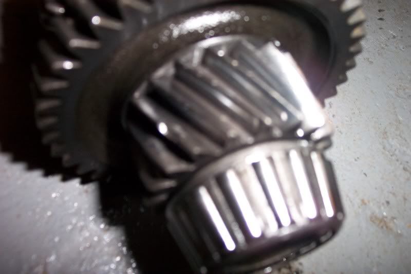

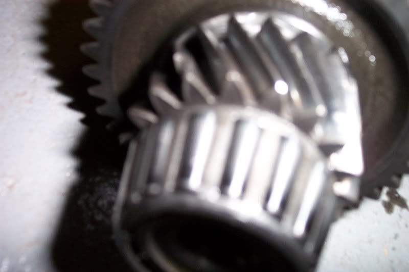

I had a closer look at my trans and I noticed also that the final drive gear on the main shaft has a chip missing from it. As far as I know that gear is part of the mainshaft itself. I'll just get another trans I and maybe a tranny shop will give me 40 bucks for all the good parts left over so I can buy myself a case of beer for when I install another tranny.

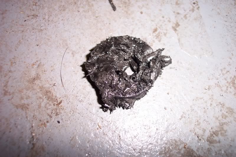

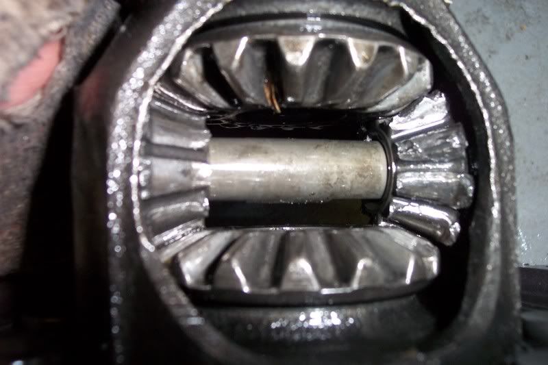

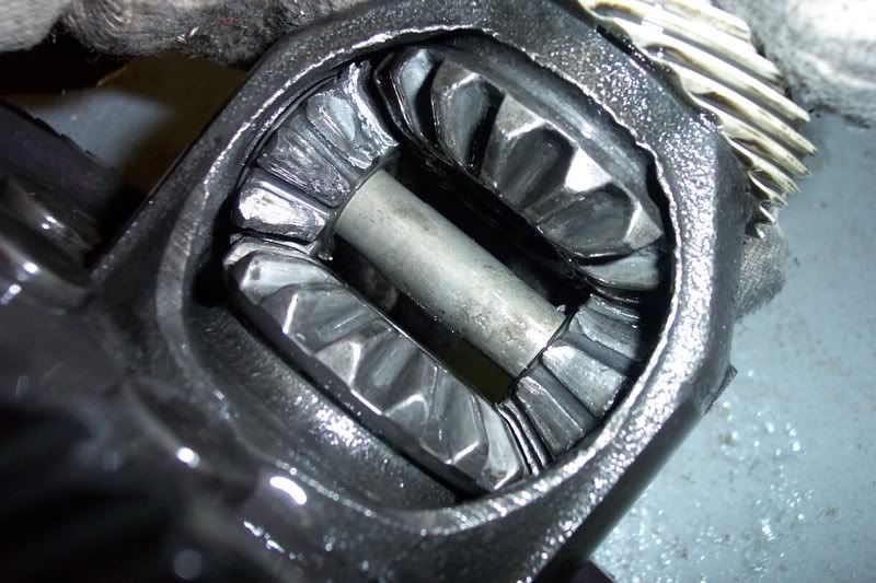

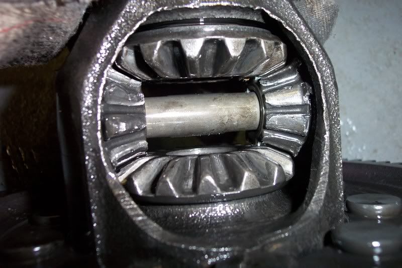

You can see the side gears have the teeth shaved almost totally off in some spots, they *should* look like the main gears and not flat. The chunk gross looking metal and grease is the magnet from inside the trans and the last two pics are of the mainshaft with a chipped final drive gear.
