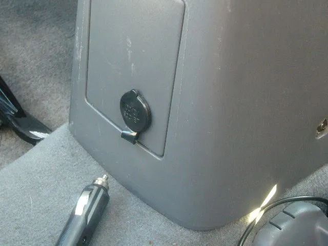

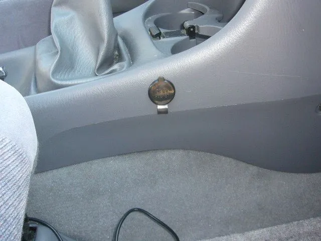

Two weekends ago I installed an extra socket in the right of side of console, and another in the back.
Just used 3M branded 12v sockets I got at walmart for about $5 each.
I removed the entire center console to drill the holes and set up all the wires before putting back in. I used 16gauge wiring, which matched the wires on the sockets. Holes drilled using spade bits, then a little bit of dremelling.
For power I used a "add a fuse" tap. These are rated for 10amps, which for my uses is sufficient. I used position 12 (see 2000 Protege owners manual p 6-11, which is always hot.)
I might decide to put a switch on this in the future. Grounding is to a nut in the e-brake assembly.
Now I can have my heated coffee mug in the right side cup-holder (the only one it fits in). I can still use the OEM 12 socket to power my phone using a compact Griffin USB mini adapter that fits flush in the socket, and the USB phone plug doesn't block the cupholder.
The one in the back is just there for the heck of it now. If you have to take the console out, might as well do it.
