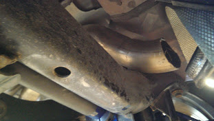

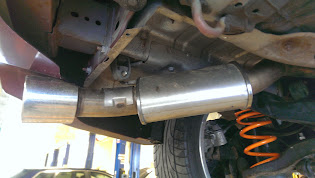

Later this summer I will be having a first gen Speed 3 muffler/tailpipe assembly custom fit to my 5. There is definitely some modification required, not just to the middle section. I've searched and it doesn't appear that anyone in the U.S. makes an aftermarket exhaust for the 5. It seems our best option is to buy for the 3/Speed 3 and pay to have it modified. I will be having a custom mid-pipe made to mate to the Speed 3 muffler/tailpipe section. I'm just not sure if I want to leave the factory pre-silencer or not. Here are some pics of a test fit:

I've been keeping an eye out but haven't seen anything. At the end of the month I'm having the midpipe made for the speed3 muffler. I'm taking out the secondary converter and resonator and putting in a Dynomax race muffler as a resonator in the midpipe. I was a bit worried about the 2.5" piping being too big but I've recently discovered that the new 2.5 skyactiv uses pipe just shy of 2.5". I would like to see a second gen 5 owner retrofit the second gen speed3 exhaust with the dual outlets. Once mine is done I'll post some pics and hopefully a sound clip.

I'm thinking that all that would take is extending a couple of the single pipe sections, possibly above the the rear crossmember and the midpipe, moving some hangers and cutting off a tow hook on the passenger side. I would love to try the 2nd gen exhaust on my first gen 5, but I already had the 1st gen muffler as freebie and I'm doing this upgrade on a budget. Let us know the details if you get it done.
