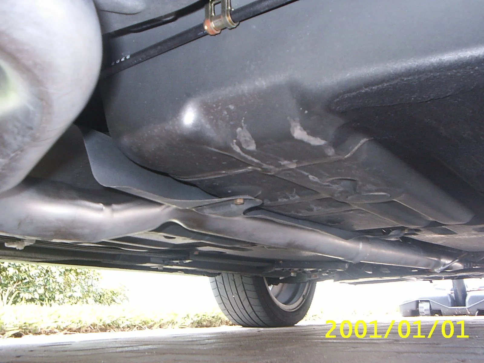

here are some pics of my exhaust...3 inches all the way back but 2 3/4" at the bends...
so you didn't go with mandrel bends? How was the performance increase with that setup? I heard we need as much free-flow as we can get.
with a turbo, the general rule of thumb is to have the freest flowing exhaust possible to minimize the backpressure against the turbo. crush bends will work just fine but mandrel bends are better. check out my earlier post for pics of my exhaust.
