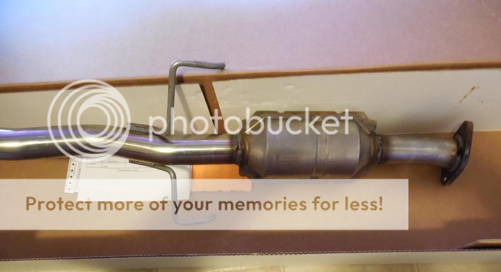

I bought a new catalytic converter. Magnaflow direct-fit version.
Well, it took awhile to cut off the old nuts. I wasn't going to fight the rust as the rubber hangers kept on flexing while I was trying to crank off the nuts.
I eventually got the new catalytic converter and gasket installed and all was smooth until I had to hook up the cat to the J-pipe. The bolts did not line up. I then recall someone else having that same issue. Having worked on the fuel filter replacement earlier, I was starting to freeze and decided to work on that the next day. I wasn't going to get the flange rewelded.
I lined up the new cat to the J-pipe and made some markings on the J-pipe's flange. The Bosal J-pipe that I had replaced a couple weeks ago had a thick flange compared to the OEM cast flange. Anyway, that took a couple grinding tips but I grinded both bolt holes and eventually got it bolted up. PITA. Sound issue is resolved. No air or water escapes the gasket.
I only got a picture of pre-install.
The old catalytic converter wasn't that much heavier than the new one so there's no weight savings. The stainless steel piping is nice and shiny, flange welds and hangar welds are nice (not super neat).
FYI: Magnaflow includes two bolts that hook up to the J-pipe side. The bolts didn't come with nuts so I got them, they are M10-1.25
