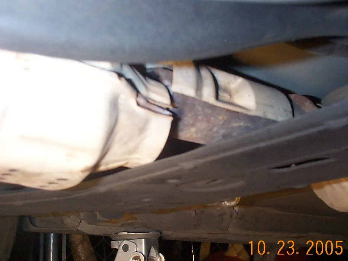

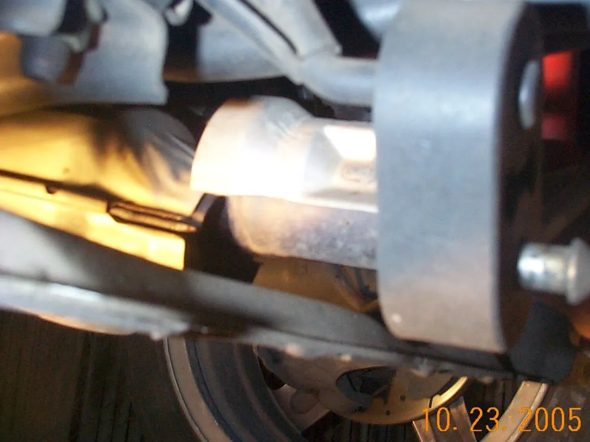

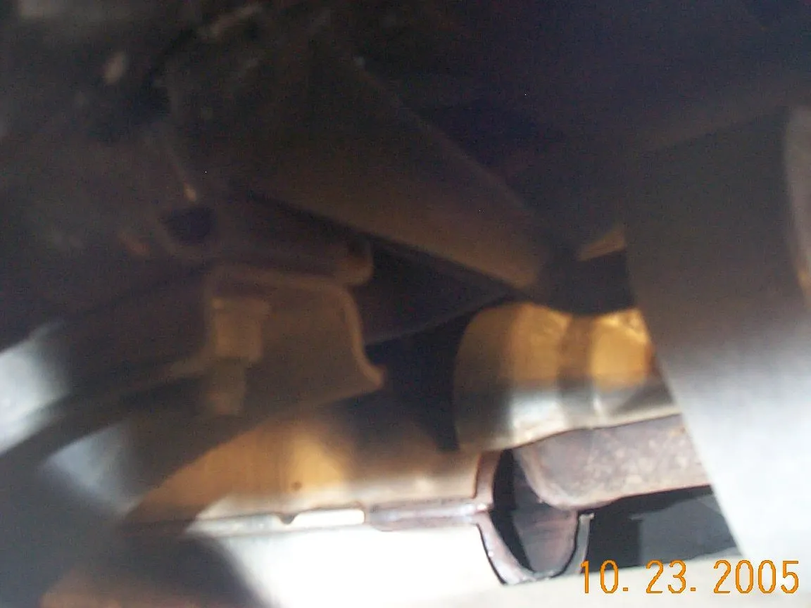

Im driving along minding my own business when suddenly I noticed my exhaust had a little more growl to her.
I continue driving along and the more I do the louder it gets.
By the time I get home this b**** is sounding fucken MEAN !
So I jack up the car and find this..........
Snapped off right at the weld!
Oh well.. guess its time to upgrade.

Mine did that too. I got them to warranty it since it's an emissions component and you will want that if you have any inspection problems in the future. And another downfall is the stupid tech flashed my car and ragged on it while it was there.
that's exactly what happened to my car as well. i miss that sound...anyway, it's not too expensive to fix. just around $50 at your local exhaust shop to weld it back together
Yeah I took it to a local shop and had it repaired for $30.
I would take it to the dealer but don't have the time to waste with them.
Took all of 15 minutes to from the time it was put on the rack till it was off.
Yep...now I'm a victim as well. Happened while I was stopped at a red light. I had hit a huge pot hole a week beforehand and wondered what kind of damage it may have done in absorbing the shock. Guess it caused it to crack and then driving it over the next week caused it to break completely off just like the photos.
