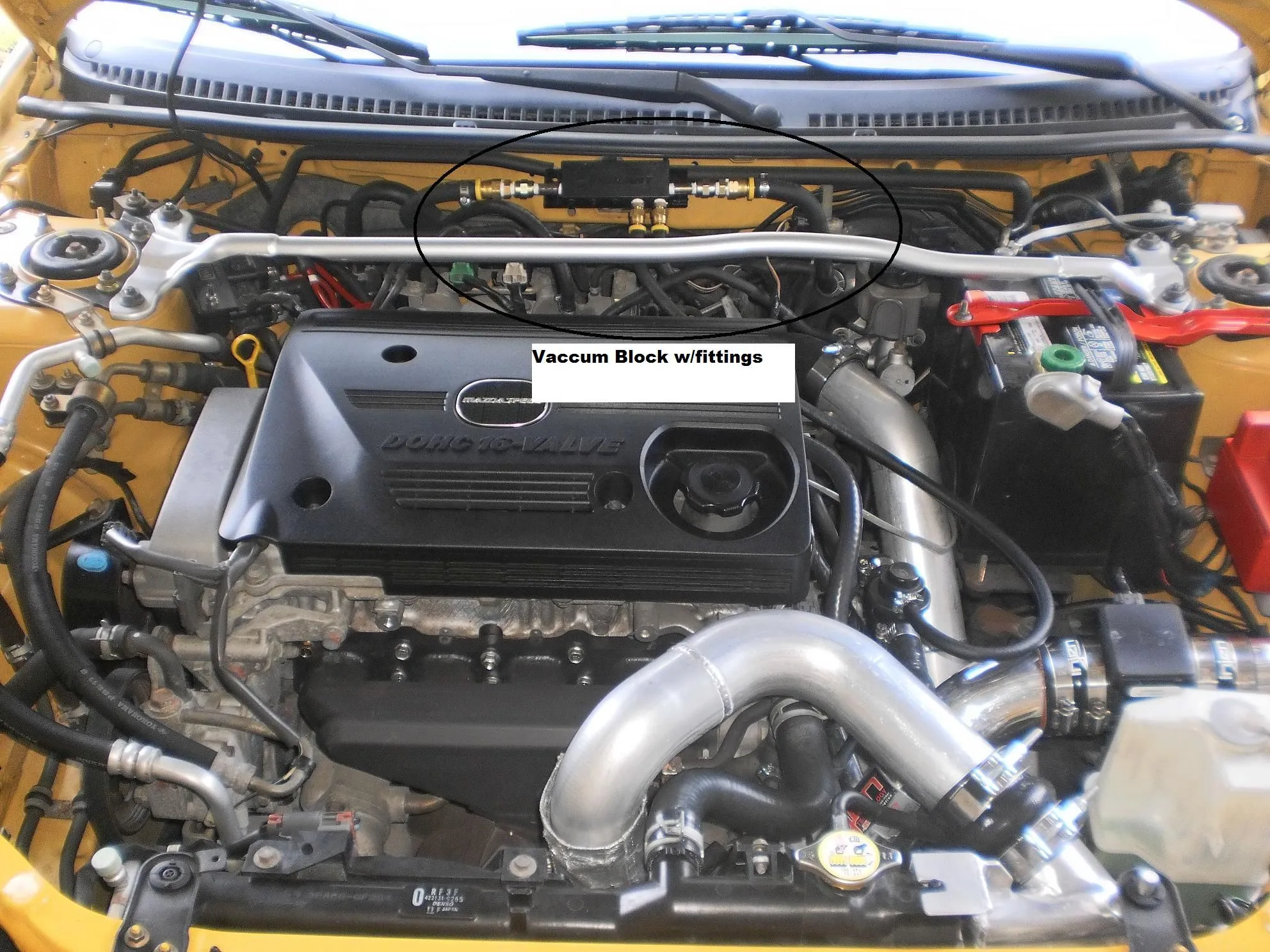

First of all... you are not going to solve the turky by running duel set up. second, you are cutting into the WG vac line already too many times, IMO you should invest in a 25$ vac block and give each there own source.

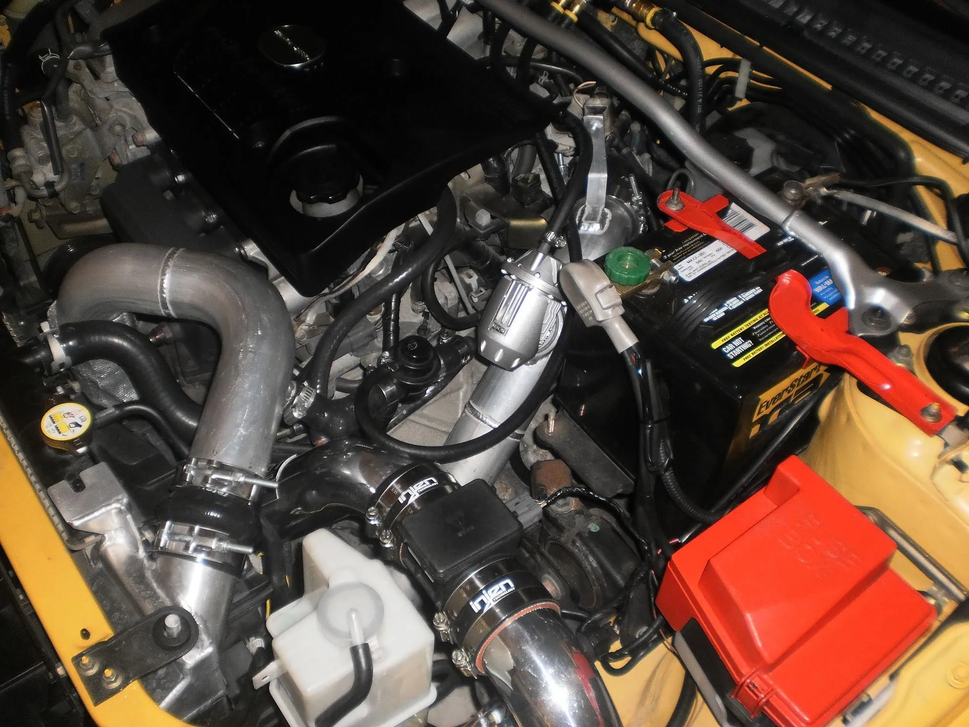

I'm running a dual setup stock bpv and HKS SSQV on Cold pipe and my MAF is still running in line with my Injen CAI and I hav NO Turkey. So I don't agree with you saying that running a dual set up won't kill the turkey.
wheres your vaccum coming from?
i have a forge bpv, stock waistgate and boost gauge tapped into the same line...
everthings fine and im at nine psi..
so im maxed out for that line where else can i tap into?

I didn't cut anything off of my CAI, I have my wastegate, BPV, and BOV vaccum line running off of the brake boost vac line using a vaccum block, my boost guage and afc vaccum line are coming off the intake mani. Look at my original picture everything is as should be no MAF relocation BPV is where it would normally be and my BOV is on my cold pipe.

there are different ways you can set up you brake boost line just do a search on the forum. some people just use T vaccum fittings to splice in. If you do decide to splice into it make sure that you check the line for a lil lump in it. make sure to cut away from it it's a one way valve (sort of) that keeps the vaccum from being lost to the brake booster.
