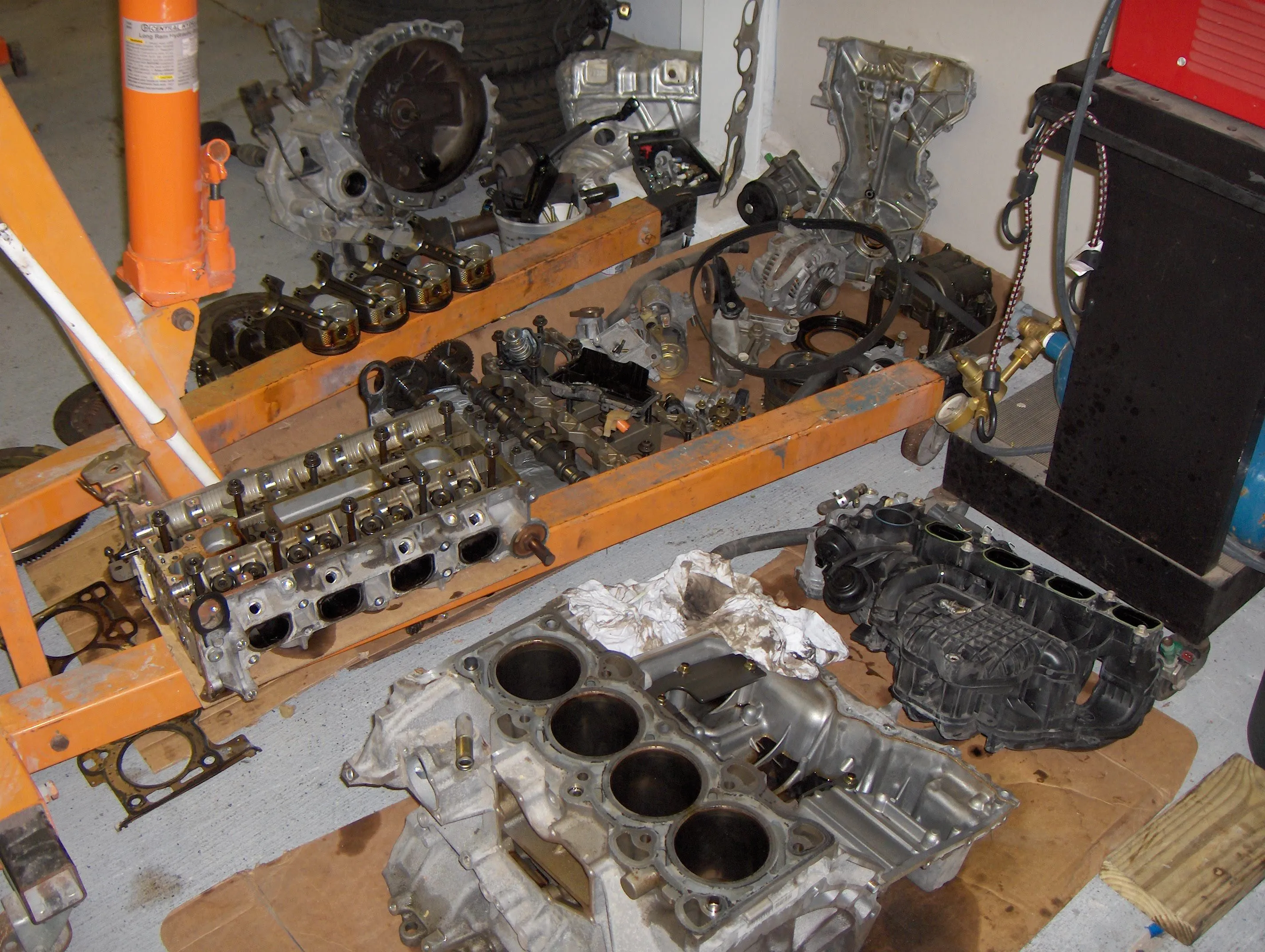

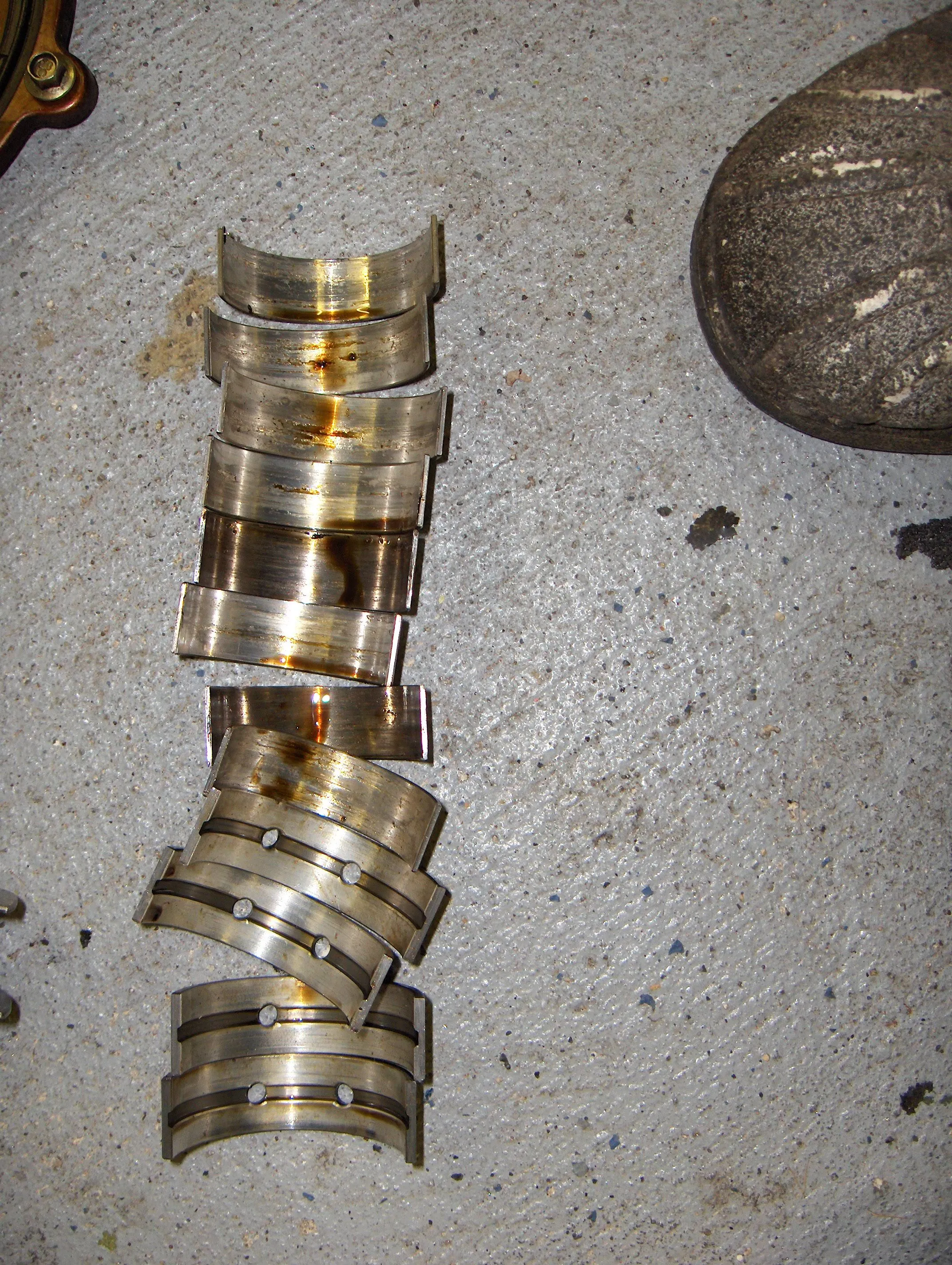

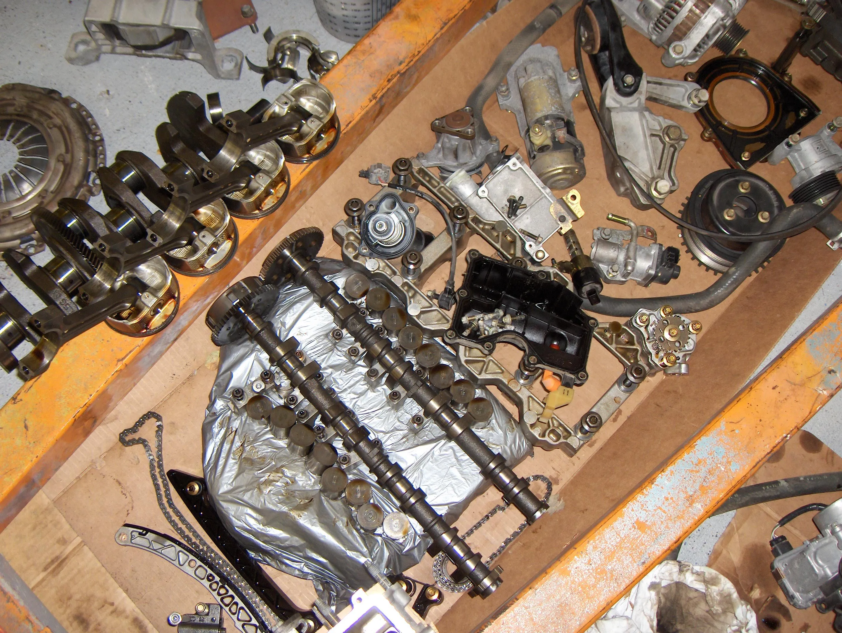

in case you werent aware im having to rebuild the motor because i spun a connecting rod bearing. once we got it apart we saw it was the #4 cylinder and the bearing was in pretty bad shape. i dont know if you can see it that well in the pics. were looking into the possibility of a bad oil pump and ill let everyone know what i find out. so anyways enjoy the pics and everyone sit back and (hah)

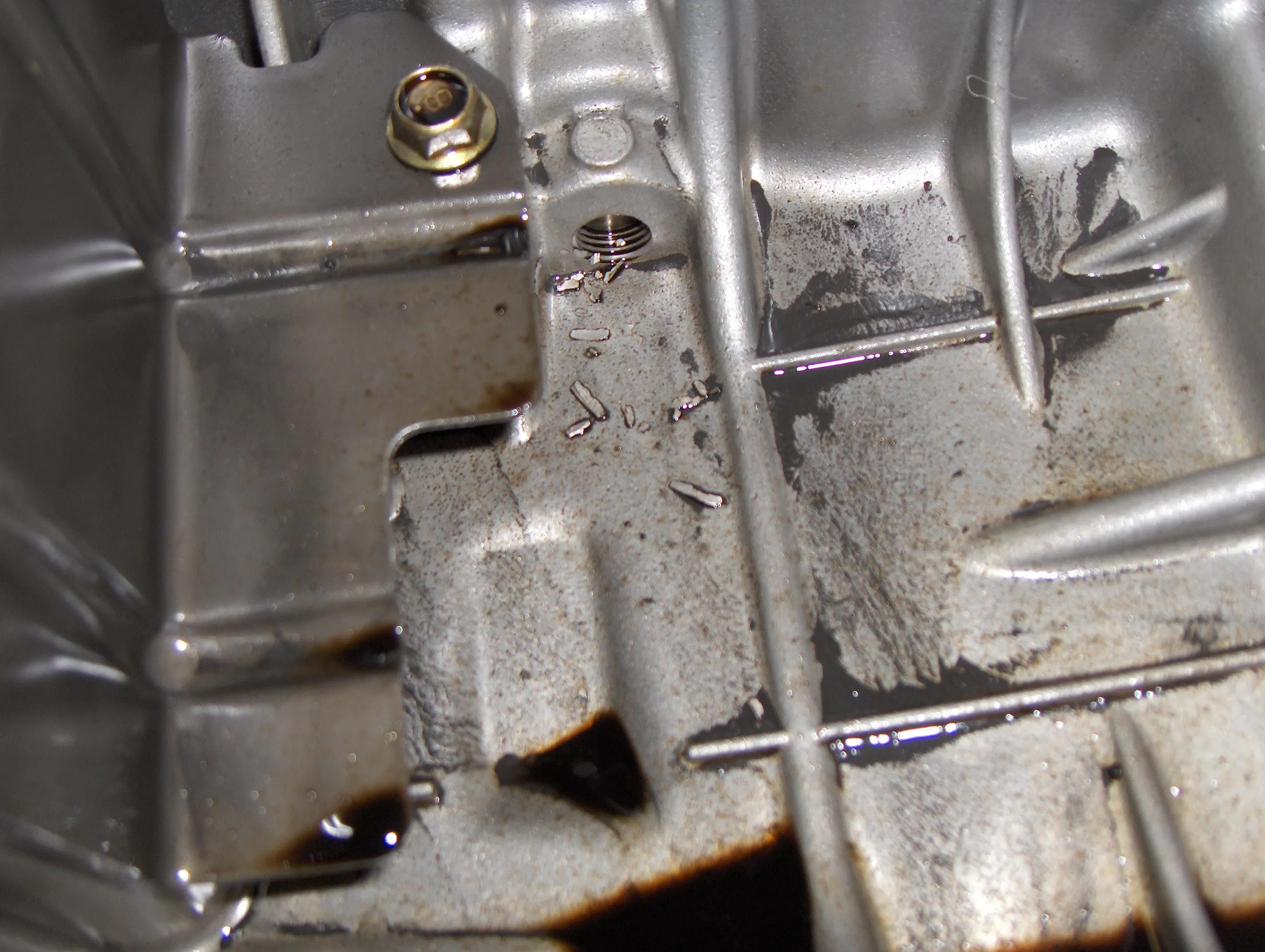

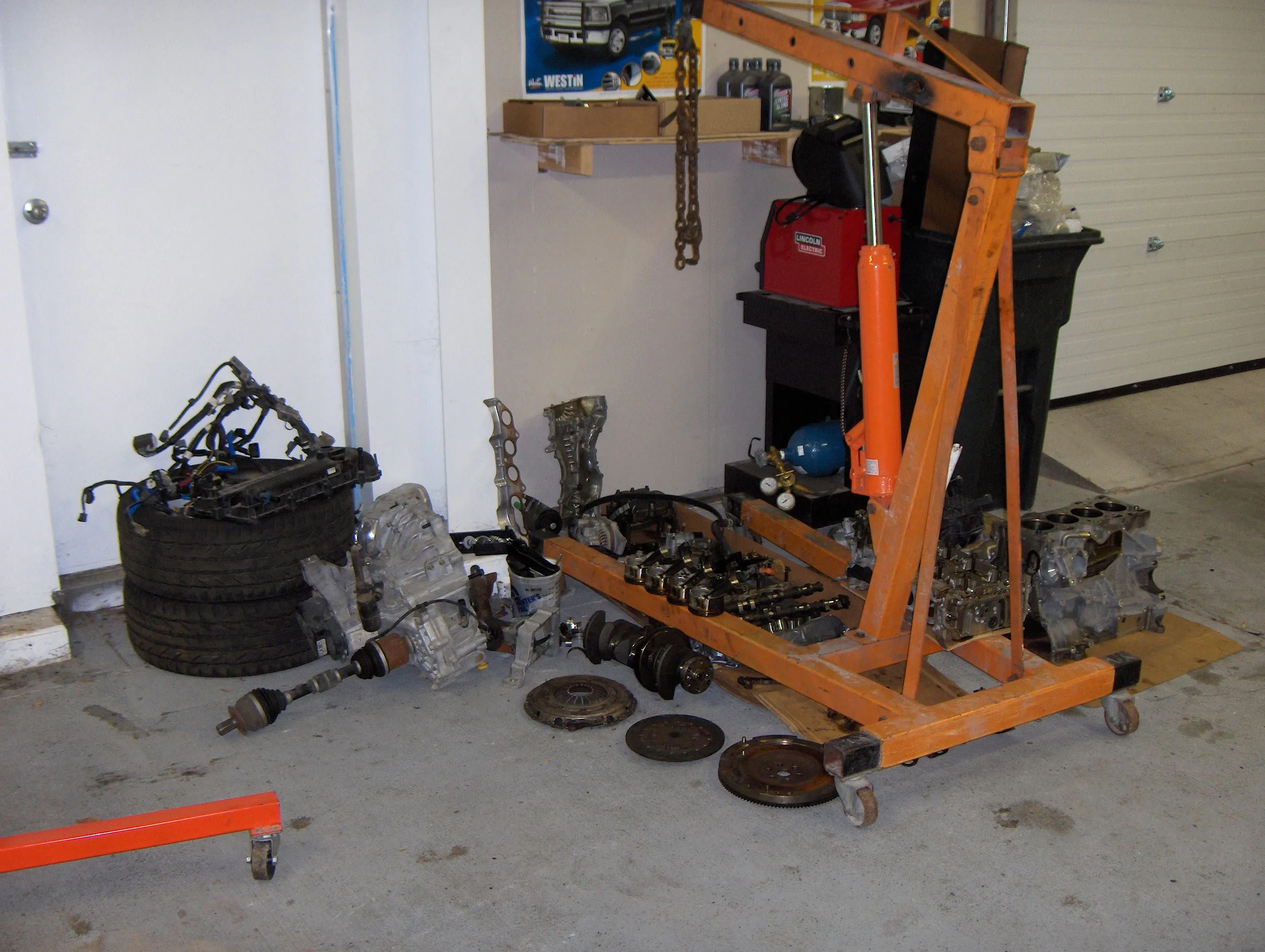

oh yeah and heres some of the crap i found in my oil pan. and to make matters worse once i got the trans off the engine i found that my clutch was almost completely gone. (first)
Damn... sometimes I hate being right. Sorry about your luck, dude. (notcool)
Did the bad bearing wipe out the crankshaft or is it ok (or at least salvageable)?

thanks for handeling my light work GW.lol. and yeah u suck you had to be right didnt ya?? the crank is still good, im gonna take it to the machine shop along with the flywheel and block to get done. im just gettin the block flushed out and then the cylinders honed. (in case theres any metal chunks in there still.)
