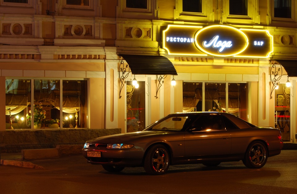

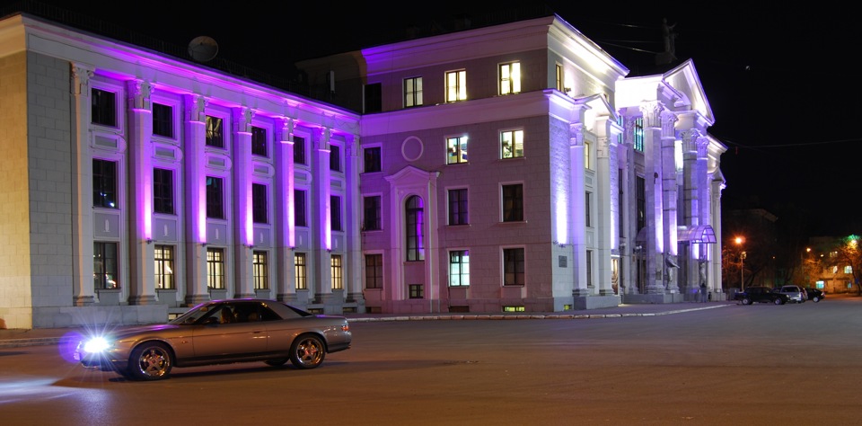

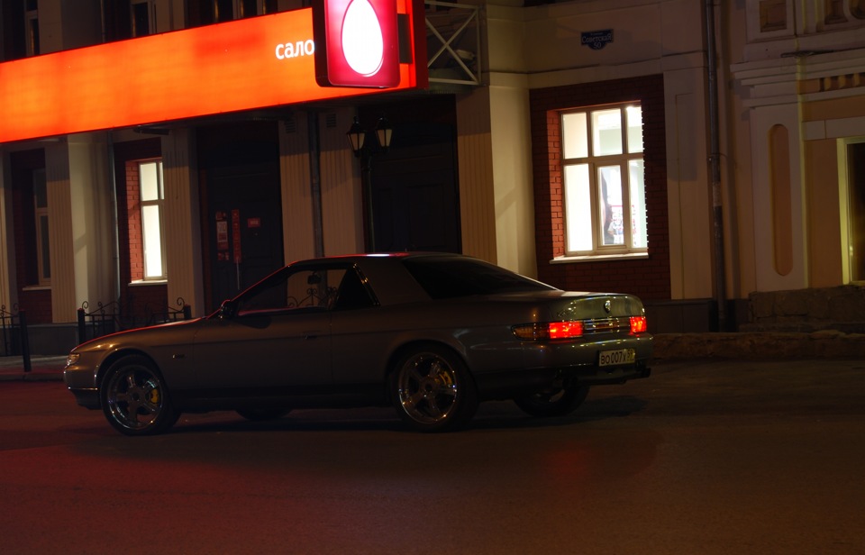

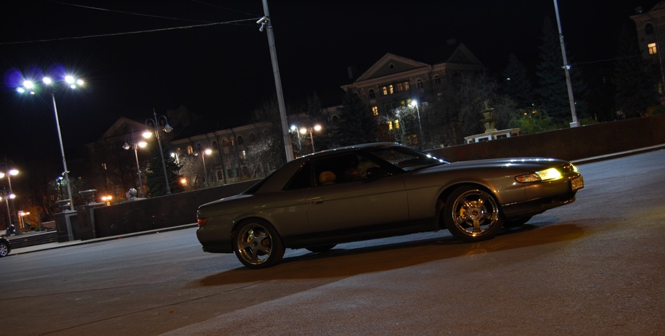

Today decided to ride, probably the last time in this season and to do a some pictures of Cosmo.
Season 2012 is over.
But it is so, in the meantime, I have not told how I restored а Cosmo...
