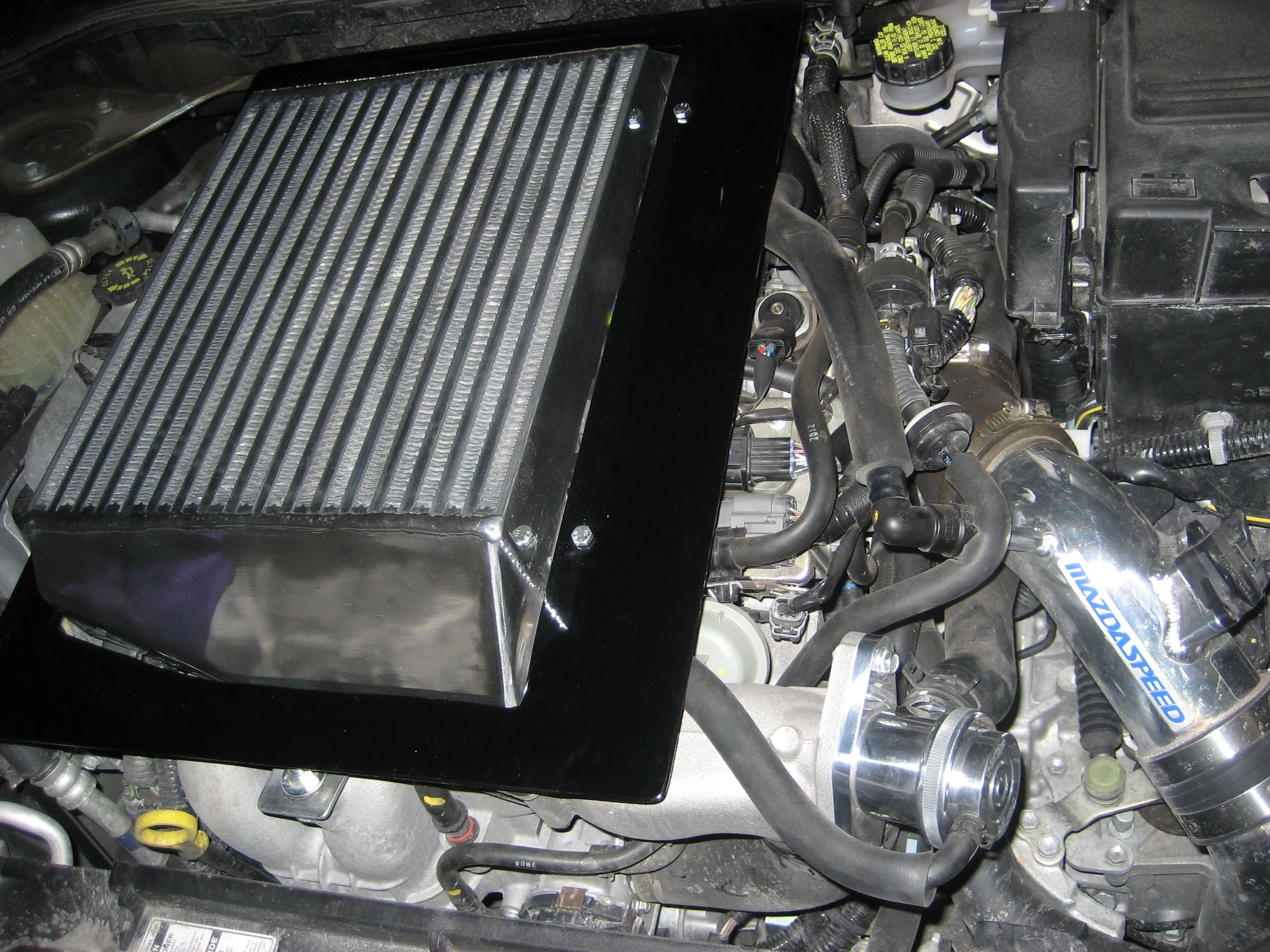

Well I installed by new ETS TMIC 3.25" and also a BPV from Forge. I can say that it made little to no difference on my car. I had a MS CAI on there at the same time. Mind you it is -4 degrees C here in Canada so I am not sure how much that is playing but I expected more out of it.
Now on the other side of the coin it does have some nice bling bling since I got it polished by ********** and the shroud is powder coated black.
I see others saying how it made a big difference and I have to say it made very little.
I have attached a picture. Sorry the engine bay is not as clean as I owuld like it but all the salt on the roads makes it hard to keep clean right now.
enjoy!

Well.. move to Hawaii! 90F Not fun for intercoolers. You'll get your monies worth outta that new TMIC!
P.S. Even if you're not noticing improvments now, your engine bay still looks sick! :D

I notice that you don't have a billet aluminum oil cap. I thought all MS3 had those.
Installed my 3.5 today! Easy to install, but finish could've been better on the shroud plate. I'll probably do somethin to clean up finish. Already did some filing to clean up edges, maybe I'll look into anodizing. Seems to function well, but Summertime will tell. Stock clamps seemed very loose as did torque on Valve so I felt better about fixing that. Did see abit of oil from pcv as I beleive is common. It's 39degrees today. A little rub mark on underside of hood in plastic air ram. I will shim backside to see if it helps. no big deal , it will be an easy adjustment yea Igot the cap red!
Well I think I spoke a little to soon. I just came back from driving around and I have to say that my bottom end is not as good as before but the high end above 4500 is stronger. It seems my power band has moved upwards with the addition of the BPV and the TMIC. So I am still happy since I am seeing some benefit and once I get my downpipe and manifold I think that it will work better. I think the computer just needed to get used to the mod since it got better as I drove it.

When you took your TMIC off did you do the stretch spring trick for the sparkplug coils ?
I did it and my power seems more consistent with zero hesistation. I used to have some hesitation and now I don't. It took like 5 minutes to do.

Mine seemed to get better as I drove the first day of making the change. The power did seems to be on the higher part of the powerband though compared to without the upgraded TMIC.

no I did not stretch but I thought about it for sure. I will have to remove again anyways. Jesse I'm not associated with a shop. But if I had access, I also would like to quantify parts and tunes There are some, each about an hour away. But It costs money and I'm spending it doing bolt ons right now. Next month i'll be able see real data on our laptops but not yet. Sparkplug thanks for reminder and help
