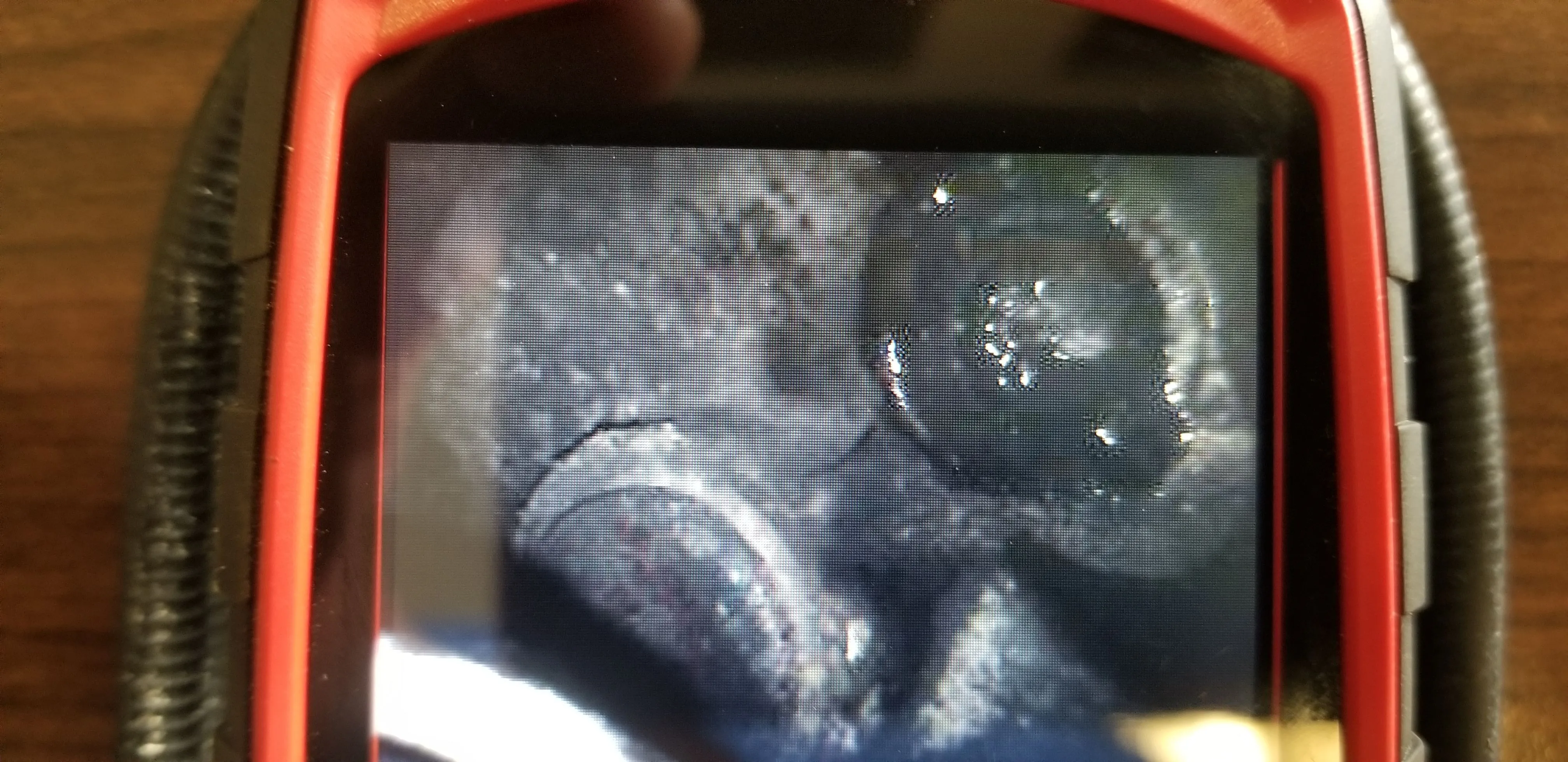

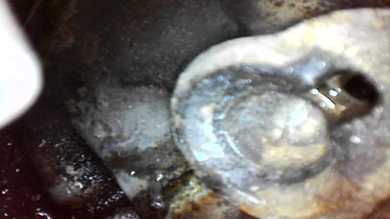

I stopped at a buddies today who has a flexible camera (endoscope) and took this picture. Sure looks to me like it’s the weep hole!!!! The dealer showed a similar picture, but it doesn’t even look like the same engine!!!! The first pic is my buddies camera. The second with the orange scope screen is from the dealer.
92 MX-3; 18 CX-5
Very good. The core plug looks solid - not obviously corrosion that it would leak. And you may be lucky to have a water pump gasket leak that is leaking external. The water pump has 2 rubber o-ring style gaskets and can leak past the first one into a channel that will direct the coolant to the weep hole by the alternator. The more insidious leak is past the water pump shaft seal and into the oil. Or both gaskets leak so the path is again into the oil.
It’s a big DIY job or a big bill with the shop but I think this is a failed water pump-just a little unusual leak exclusive to the gasket seal.

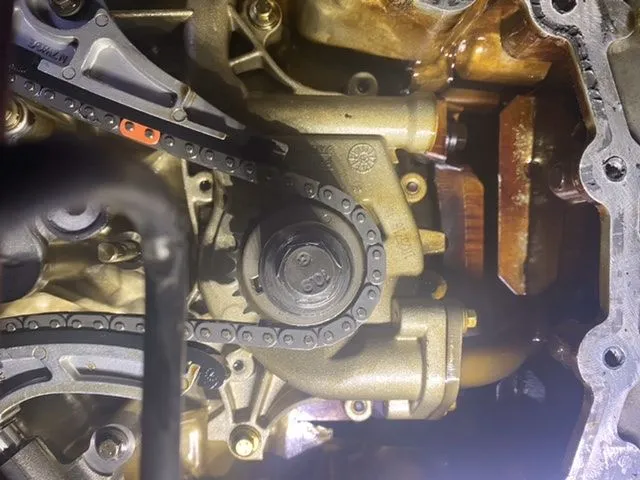

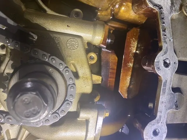

Here is where we went wrong. 74421890-C802-408F-8FA2-D7A161A02A82.jpeg 9D2AB70D-53F6-4CAE-9D7E-072E7DBD2BDF.jpeg
On our first attempt we aligned the timing mark on the crank with the groove at approximately 5 o’clock. This put the crank key-way at 12 o’clock. We missed that. The big ol groove just seemed an obvious timing alignment mark that we adjusted to fit that as best we could, which in turn ate the motor.... Or more likely bent a valve as puma says above.
