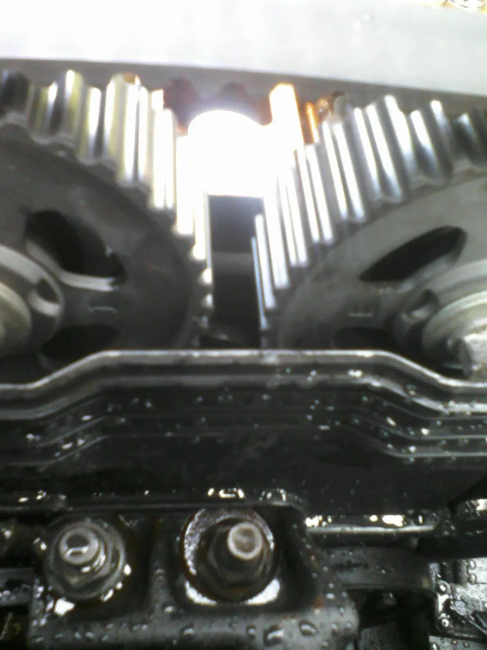

I'm leaning more on timing right now, because you have spark on both coils and wiring has been checked out. Timing belt should look like this:
yes i have good pressure for sure. what is the eaisiest way to check timing in this car...it almost seems faster to pull the motor lol
ok pulled valve cover ...both cams are in perfect time.
ok update:
i tried to start it again with the intake off..the back firing is coming from intake which would indicate timing. but according to the marks its timed right..any ideas>?
just follow focuses diagram, looks like your going to have to pull the engine though to check the bottom end
Doesn't need to pull. Stick in a pen or pencil in the first cylinder and watch it to see that it is a TDC when the timing marks align on the cam gears. The pencil should come up all the way, and if you go past it will start to go down again, that way you will know Top Dead Center on cylinder 1.
great idea..honestly didnt think to check like that...ok so its at TDC on Cyl 1 when marks are lined up.....now i really am lost
Let me make it simple. When I and E line up as in the picture above, the pencil in Cyl. 1 should be at it's highest point.
