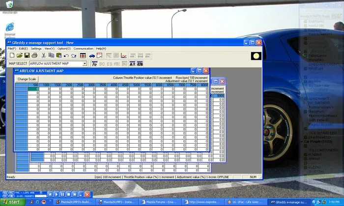

Bigg Tim said:
How about some screen shots too? I'd like to see what the interface looks like.
here you go, if you want to see some more, just ask.

Nice man, glad to see its working well on a mazdaspeed now. How is your timing hooked up? Just directly into the wires from the emanage, or what?
