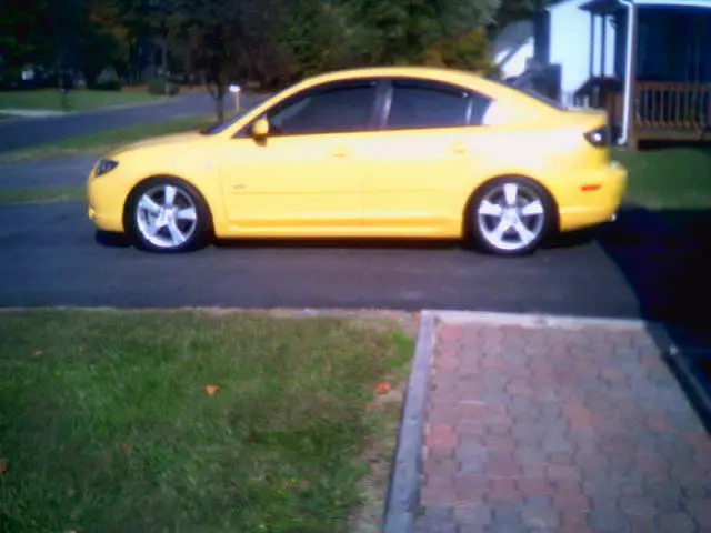

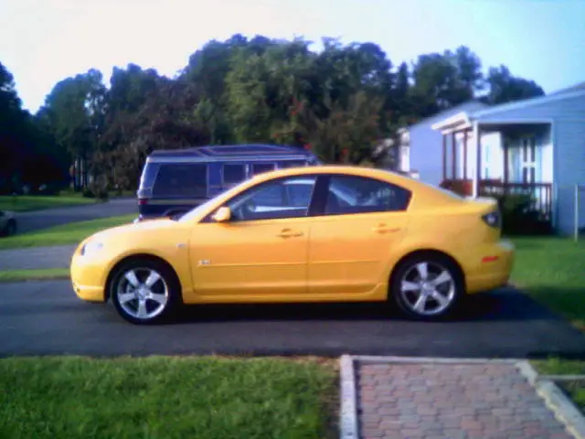

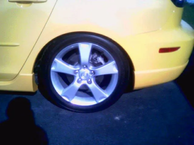

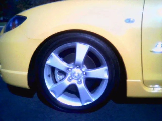

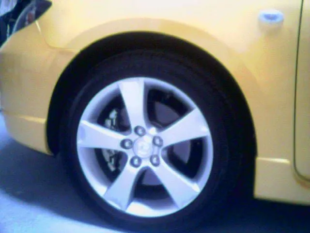

12 am and i just finished the install of the eibach sportline kit! only took about 3 hour easy install, eibach said 1.8 drop it was just about right on the money i figured it at 1.9. should post some pics on this thread very soon.
pics for the last nights sportline drop
here they are , a couple before and afters

wow, very nice stance... looks perfect, love it!
