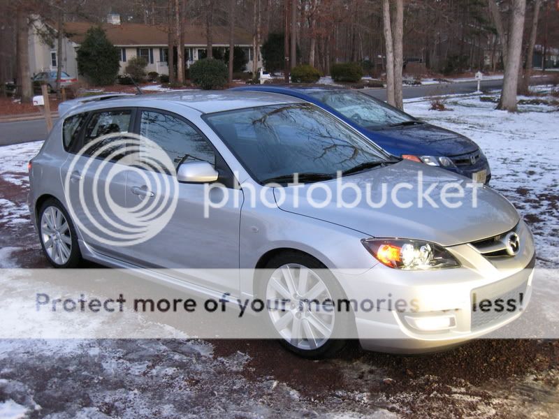

Eibach Pro-Kit on '08 MS3, installed
I put these in today. installation was a breeze, the only hiccup was getting the bottom of the front struts out of the pinch bolt area. Ride quality is not degraded at all vs. stock. it's very cold and somewhat icy out today, as you can see from the pics from the snow and the vapors from the idle, so i didn't test the handling too much, more on that later.
i also put the corksport mount insert in and did the PG spin-on filter conversion. the mount insert made the twm shifter and bushings a complete upgrade now...
stance looks good.
they'll prob. settle a lil more and look even better.
thanks for the compliments. tho i actually hope it doesn't go any lower because this is ideal for me with those 18's!
eibachs are block set at the factory so they ideally shouldn't 'settle' to a noticeable degree.

i forget the rates, they are on the springs but i didn't look and i don't have a sheet on them. i can find out for you. the amount of lowering is i'd guess about an inch or so, since i think the MS3 is 10mm lower than the regular 3, and these drop a regular three approx 1.3 inches.

looks almost identical to the drop I got with my Mazdaspeed springs. Maybe .25 inches lower in the front.

i actually have yet to check it out in a conclusive manner. i am going to keep an eye on these tires and see what happens with them before decide if i need anything in the area of camber management. the rear looks like it's got a healthy amount of rear negative camber, however, on these FWD, if you are rotating on schedule, you won't see that effect much before the tires are beat anyway from normal use.

Powerslave, the inserts are super easy, tho i removed more bolts than they suggest to get it in. they say remove the two for the mount, i removed those along with the bolts of the thing that the mount connects to. anyway, super easy install, maybe 10 minutes from start to total finish.

this is interesting. i talked to the factory and i was very surprised at the information.
the front springs are 160lbs, but linear rate, not progressive. the selection of spring is based on the suspension geometry of this car. i am used to honda rates being higher but the geometry is different on those cars, and the rear configuration is totally different vs. a honda. the rear springs are also linear, and are 171lbs. they feel somewhat stiffer than stock yet yield a very comfortable ride, so i am unure of what the stock springs for this car consist of in terms of rate.

Those rates are for the Eibach springs? I'd like to find out what the OEM spring rates are.
So with some searching I found this from grassroots:
So far I've found second-hand information that appears pretty solid, but it is internet second hand information.
The intarwebs says:
f=33N/mm (188lbf/in)
r=30N/mm (171lbf/in)
Also I looked up the Tein SS coilovers spring rates and was surprised at how much stiffer they are.
336 lb/in front
392 lb/in rear
Might be a little too stiff for me.
http://www.tein.com/products/super_street_price_list.html
interesting. i think we now know why my ride quality hasn't changed ; )
so basically with the eibachs i have on the ms3, i am lowering the center of gravity with little to lose in terms of ride quality however it seems i'm leaving a little left in the way of potential increase in rates.
