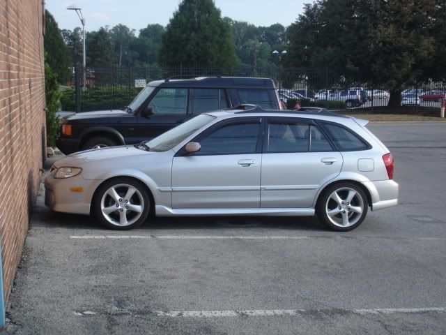

stock MSP next to stock P5, i thought that the p5 was a bit lower?
(I actually measured the sideskirt clearance on my P5 vs my roomies MSP)

stock MSP next to stock P5, i thought that the p5 was a bit lower? (I actually measured the sideskirt clearance on my P5 vs my roomies MSP)
MSP's suspension is 0.75" lower, but it's tires have a 0.4" larger radius, so measuring form the side skirt the MSP should be only slightly lower than the P5, assuming both cars are stock.
ok, I knew that it was something like that, I must have done the measuring after my drop.
