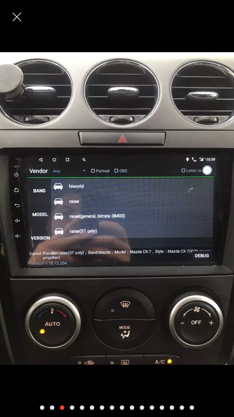

These are the settings for the 2014 Mazda 5 that work for me on Otojeta radio from 2020.
For the 2008 Mazda 5 I used to have, the box came pre-configured with the stereo, I didn't even have to dive into the factory settings to select this.
Thanks for showing your box: MZD-RZ-05; SW: V0106.
I wonder how different is it from MZ-SS-06; SW: V1.01..? Note this box has two different dates 20200714 vs 20190710 in the Russian video.

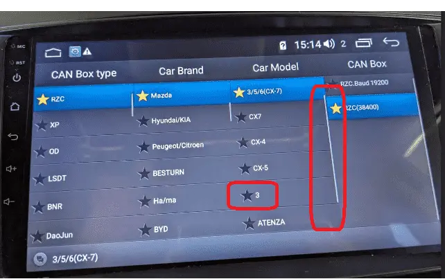

If you scroll down, do you see more options? Did you try to set it to "3" (Mazda 3) to see what/if any different option/experience exist?
I am fairly certain all Canbus signals are decoded in the latest box (I'm guessing which box and version will determine how much/up-to-date it is). What I'm hoping to see is software option to interpret and ability to control the display via the Android unit or OEM display panel (clock and radio area). Think Android units that are design as OEM replacements for current cars (ex. latest gen BMW) that includes controlling HVAC, etc.
For example, Mazda has steering angle in canbus (+'06 Mz3, not sure how far back it covers). It is simply a matter of the Android developer to translate the steering angle to steering lines and superimpose it on the screen when the backup signal is triggered to show projected steering lines when backing up.
Check the reviews (and pics) for Canbus RP5-MZ-002 (V2.20.007CYN, Date: 20221229). Technically for 2004-2009 MAZDA 3/ AXELA and 2014 MAZDA/CX-7 but I'm willing to bet it should work exactly the same for Mazda5/Premacy (you might need to change the Android's car Model and CAN Type to experiment. It's also possible your specific Android's firmware does not support Canbus functionality very well.

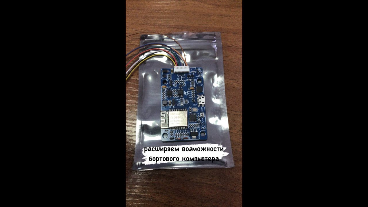

Does the Canbus unit have an IP address you can logon/configure? Some of the links you ref above appear to be Russian, hope you can understand this and help translate it. It does look like he has another module (exposed board) plugged in but can't understand what he's saying :(
Still can't fully understand but found what he is using from another video. It's a custom Canbus decoder created be a fellow Russian, not avail here. You connect to the PJCAN via wifi (EDIT: Bluetooth!) connection to configure it on any browser on any device. This is nicer to have than a standalone Android unit (EIDT: must be used with an Android unit), and definitely complements it for a full seamless setup, IMO. I wonder if RP5-MZ-002 offers something similar functionality b/c the reviews/pics seem to show it has some ability to access it to config and change clock display (might depend on the Android unit's firmware capability).
What tasks does PJCAN solve :
- The most important task is the operation of the on-board computer! Now you can switch the information display (LCD) to the consumption mode (INFO), switch readings and set the clock, as it was with the standard GU;
- Steering wheel buttons now work without dancing with a tambourine! They can be programmed! Supports double, triple press and hold of the button;
- Information display (LCD) is no longer a dull city, but with the inscription "Navi System". With the PJCAN 4.0 adapter, you can display any information on it. Would you like to display your nickname or logo, please! Do you want it to greet you when you start the car, please! Do you want to see information about the state of the internal combustion engine, or consumption, or the status of open doors, or ..., or much more, please!
- For owners of the Bose amplifier, all the functionality of this device is now available. The music played like with a regular GU and maybe even better;
- No need to be the master of GU and cars, just replace the Chinese friend (adapter) with PJCAN 4.0. You don’t even have to throw out the box, PJCAN fits perfectly in it!
PJCAN
Note how the HVAC controls menu pop up when a HVAC button is pushed, you should be able to change settings on screen (EDIT: it is only ONE-way display and not interactive). It disappears b/c the firmware is not built to have the HVAC controls on full time as it takes up space (need tesla style screen for more space).

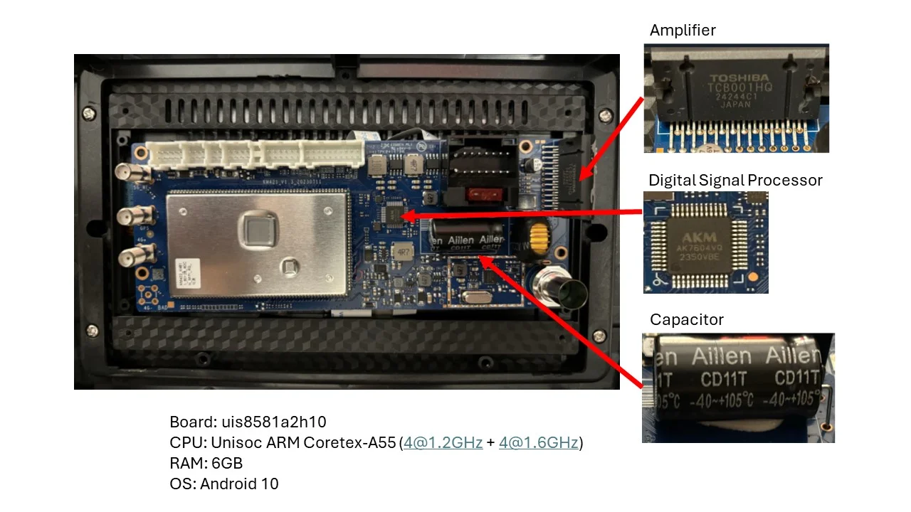

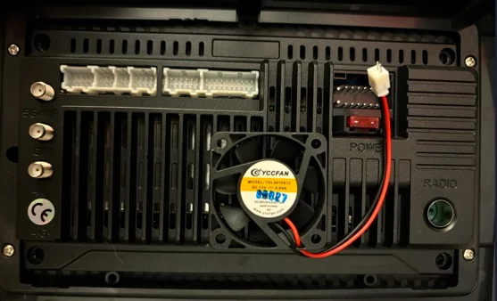

@SuperClust I went Janky (sort of)😊. Figure I close this thread with some factual data in a TL: DR update. In short, there are a different variation of PCBs and components that can be spec’d –and YGWYPF still applies. Prices have dropped so I settled on the next best (*cheap*) unit @$140 (stay <$150).. Change default the stock launcher to Vivid launcher (much better UI) BUT be aware that if you integrate Vivid to Google Maps and Spotify (for example), the boot loader will include these apps! Stock launcher does not so it boots more quickly – choose your poison. Bench testing so far but I LOVE it, touch and response is fluid, better than a lot of OEM systems! Zlink allows full wired/wireless Carplay and screen mirroring (.25-.5s delay). There are a TON of things to unlock in Factory Settings, a lot I have no clue. DSP has a ton of flexibility -wow. My main concern is with durability against summer heat and knowing sound will be marginally acceptable (least of my concerns, as long as I can hear it).
PCB Layout
AMP: https://toshiba.semicon-storage.com...t_en_20220727.pdf?did=29411&prodName=TCB001HQ
DSP: https://www.akm.com/content/dam/doc...-processor/ak7604vq/ak7604vq-en-datasheet.pdf
Capacitor: https://www.aillen.com/data/upload/20230111/63be376fd4827.pdf

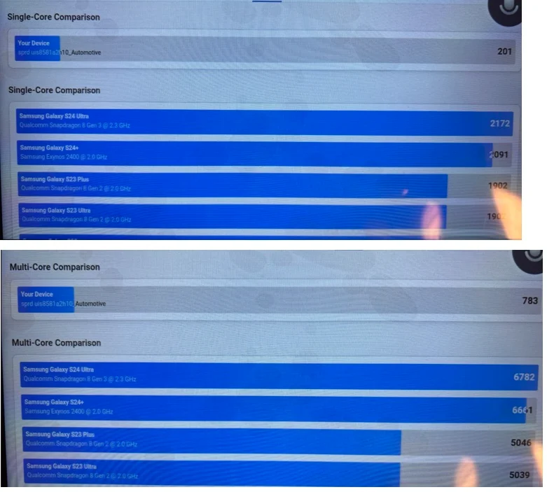

Geekbench Score: sprd uis8581a2h10_Automotive - Geekbench
Make sense to compare it against the latest Android (scrolling down to compare against lower spec phones makes more sense but it wouldn’t be as dramatic 🙃)

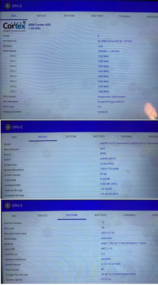

CPUZ
This unit’s board is somewhat new’er (2020-2021?) and not well known on XDA but I’d file it under mid grade of the janky spectrum (solder quality, flux residue, components not the best). In general, it seems units based on FYT board is the best starting point. I decided to add a fan (zip ties FTW, tested case fan but it is too loud and I don't want to buy another) and add extra small heat sink on amp side. Waiting for the Canbus to arrive for the real fun 😊
I think this is important to call out. First thing I did was run CPUZ and Geekbench. Note that with the stock build, it is consuming ~2.5 GB memory!.. Android itself takes a chunk of memory and the bloatware makes it worst. Anything less than 4GB (bare min) is shooting yourself in the foot.
