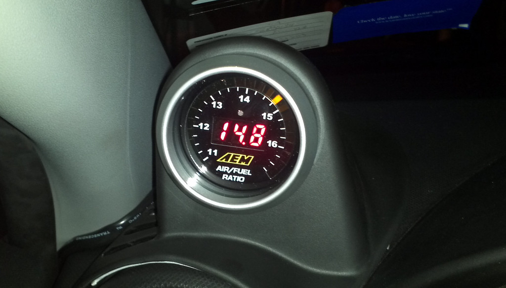

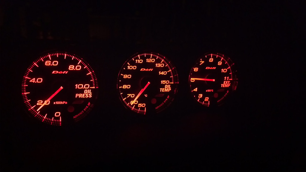

just some pics of the gauge set up
went with defi advance BF for oil pressure, oil temp and exhaust gas temp and AEM Uego Wideband for A/F
with CP-E center and side gauge pods

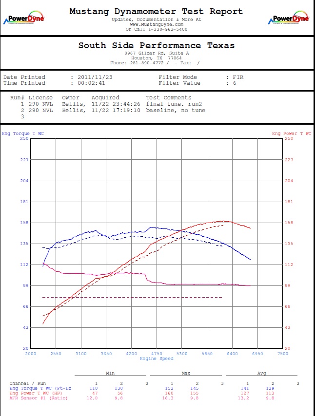

We ended up deciding to tune it using mazda edit, which initially we ran into a few issues but got it set up eventually.
The car is currently making 160whp and 153 ft-lb on a mustang dyno, they also were able to raise the speed limiter and raise the rev limiter to 8,000 RPM
(dynojet vs mustang dyno, dyno jet tends to read 15-20% higher http://g35driver.com/forums/engine-...ction/26743-mustang-vs-dynojet-good-read.html)
there is still some power to be pulled out via tune, but there were some tables not included in mazda edit that the tuner would have liked to see. He is emailing the programmer who made mazda edit to see if we can't find the tables he is looking for. The mechanic who built my motor was telling me that mazda edit seems to be leaps and bounds better than the CP-E standback he has on his girlfriend's boosted 3 sedan
