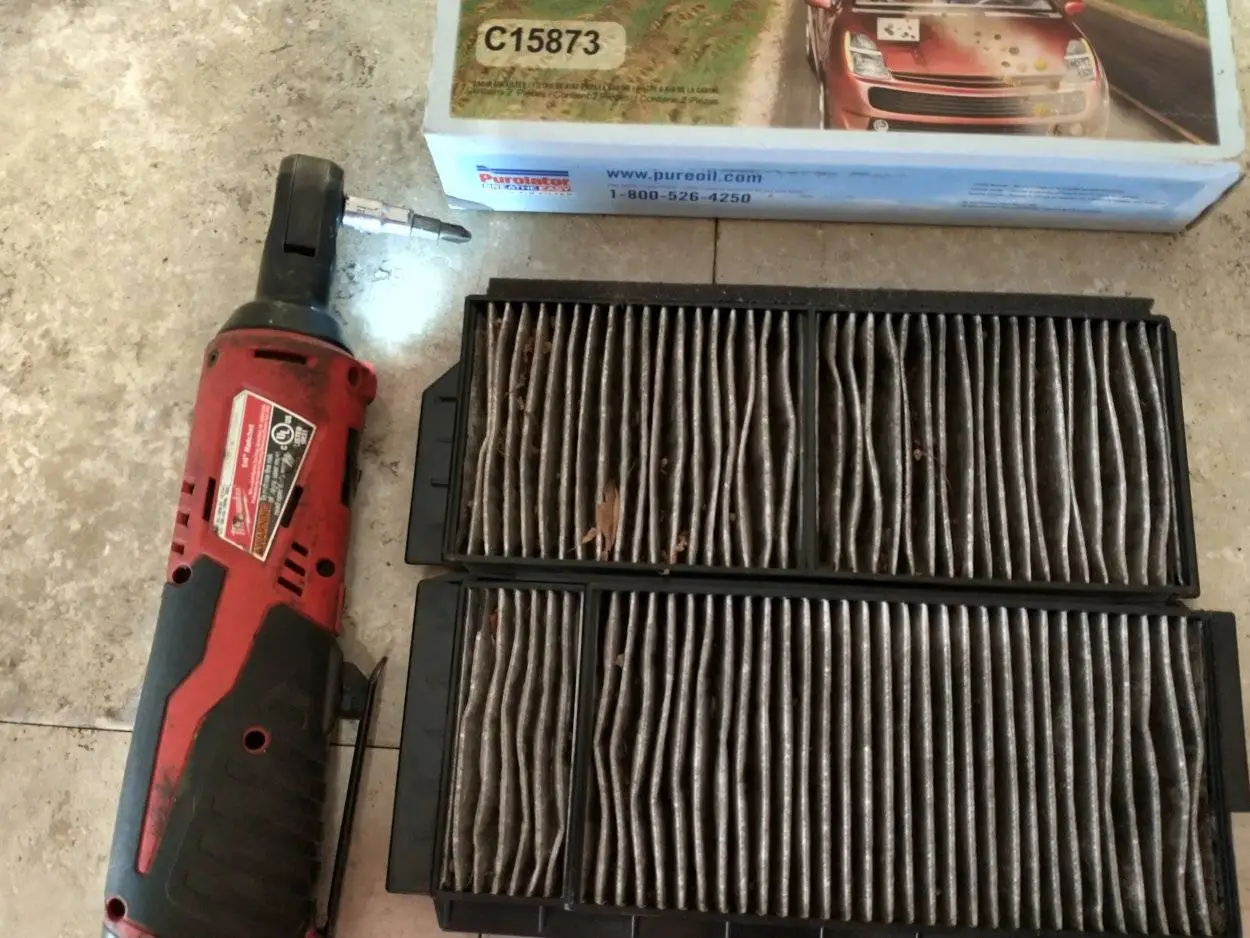

To make the cabin air filter change from horrible to a simple this sucks task, use an electric ratchet with a philips screwdriver bit. If you don't have a philips bit, use electrical tape to fasten a philips screwdriver bit to a 1/4" socket. The light on the end of the ratchet helps a lot, too.
Makes it SO much easier to remove the screws. I just changed my filters in 5 minutes flat.
This trick also applies to Mazda3s.

But I like the looks of that tool. I need to obtain it.
