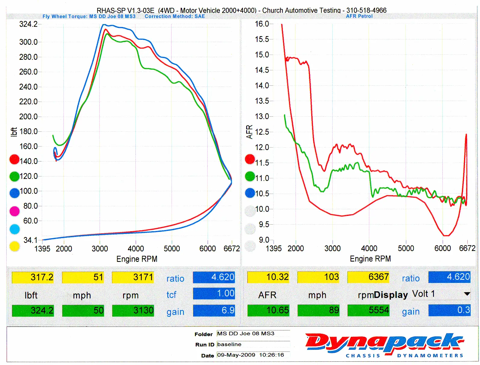

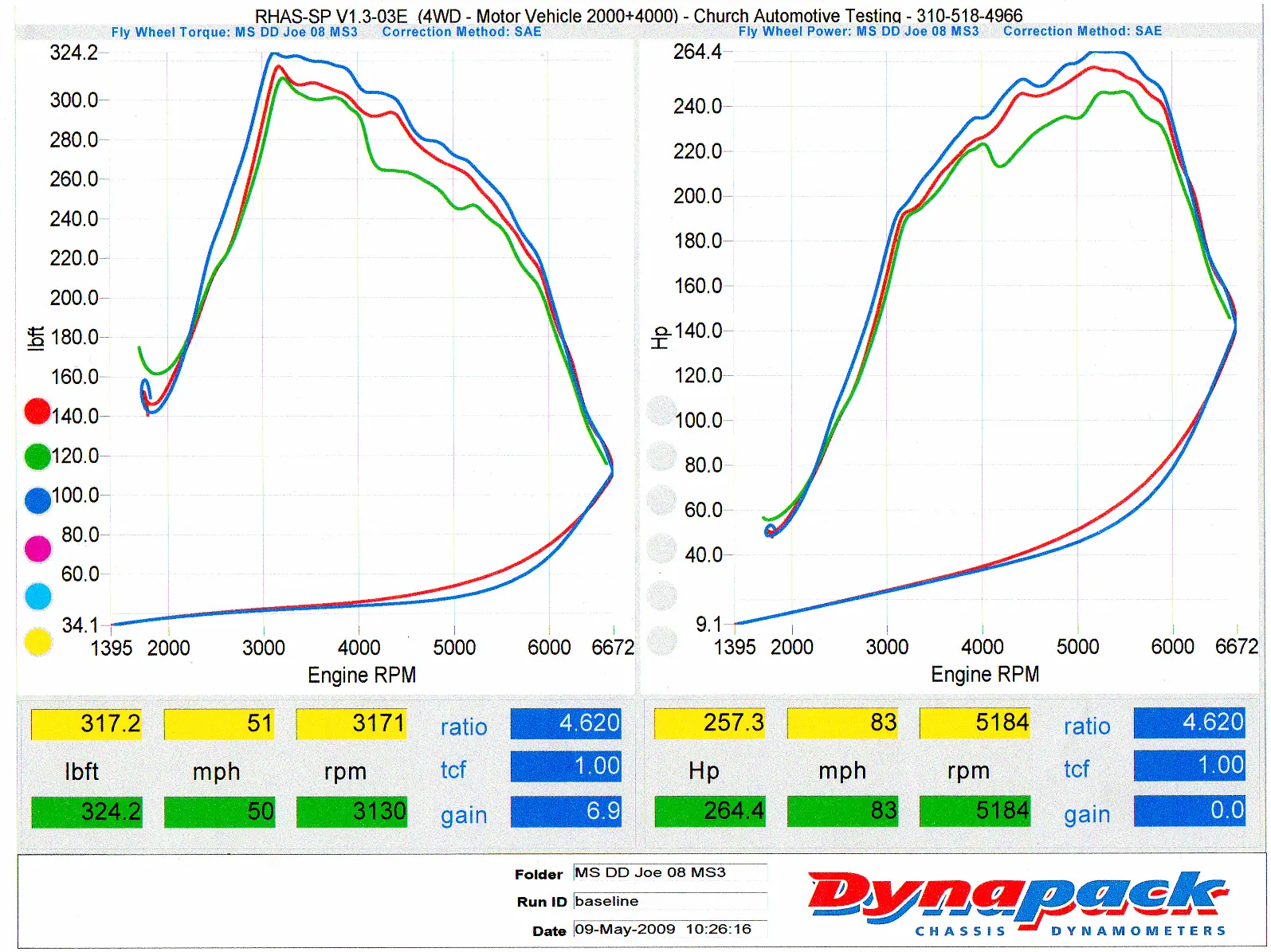

just to clarify, yes the numbers are corrected numbers to the flywheel. I was at the same dyno day and pulled this:

Joe, were you the Silver MS3 lowered on MS6 wheels? Weren't you running the Cobb SF and some other tuning? Could be wrong... otherwise that's a very weird readout indeed. My buddy with the S2K that day dynod 244 whp with a reflash, exhaust, and headers. That's about 5% higher than similar readouts on a floor dyno, but not a huge difference.
In any case, here's some clarification from Shawn Church regarding his dynapacks:
1) Our dyno reads exactly the same today as it did 7 years ago when we first bought it. I tested my S2000 on it (stock AP1) the day it arrived and it made 212-213 hp vs. 200-201 on my local Dynojet. There are no correction factors used.
2) The easy way to tell whether anyone is fudging numbers is to use the preformatted screens rather than the comparison window shown. The preformatted screens for "flywheel" (on the older software) power/torque include a box at the bottom for TCF which stands for Transmission Correction Factor. As long as that value is 1.0, what you see on the plot is what was measured at the hubs. We never use the comparison screen as shown because it tends to confuse people as well as be open for manipulation.
3) A Dynapack should always read higher than a roller dyno. Physics dictates it. If you don't believe that, then you must believe that roller dynos are inflated. Considering that in inertia mode, Mustang, Dynojet and Superflow have all been shown to be within 1%, this is unlikely. The cause for higher readings comes down to driveline loss reductions, primarily in wheel/tire inertia and in rolling resistance elimination. See SAE Paper #2002-01-0887 You'll have to pay to download it, but the testing data is outstanding. You'll see that rolling resistance losses alone on a roller dyno can be quite large. In the test case, it was shown that for a 245/50/17 tire the losses were 16 hp at 110 mph. This is a loss that will not be present on a Dynapack. Something to think about

the only true power adder if have is the COBB SRI. No tune or anything. Other mods would be grounding kit and Forge BPV. Other than that no other power related mods. Yes I was on the MS6 wheels.
