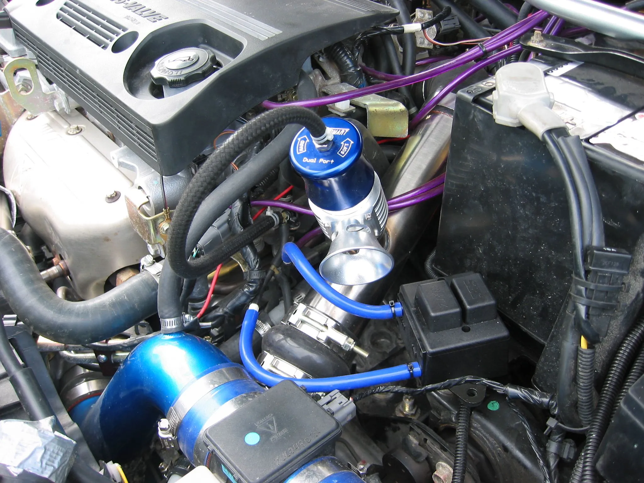

I run a TURBOSMART dual port and my stock BPV because with the turbosmart only , my car was still stalling so i have add my stock BPV and cure the problem with that... no more turkey :)
