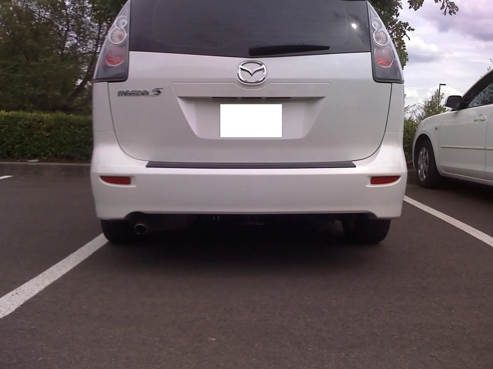

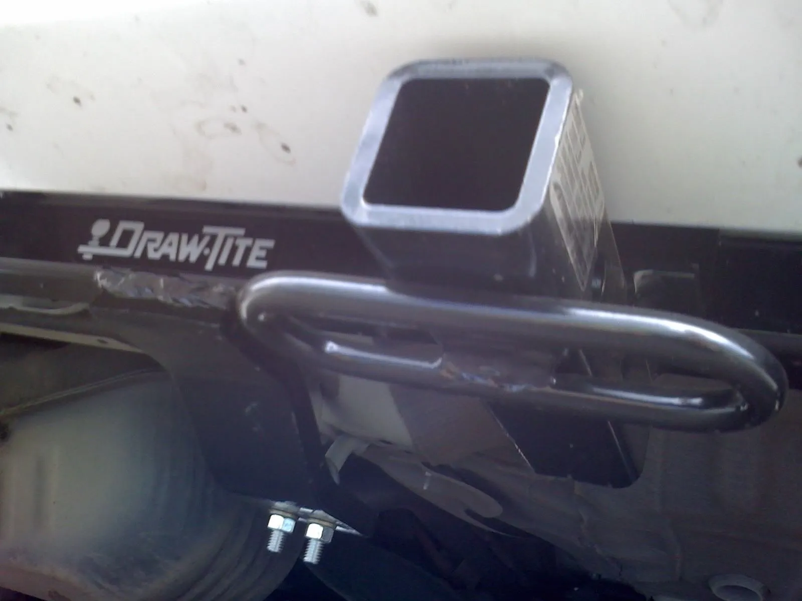

I highly recommend this hitch. It comes with the stinger n all if you ever wanna tow anything, but for me the really cool thing was the completeness. They include a slick little tool for feeding the bolts into place, not sure if the hidden hitch includes it too. Here's some tips tho. I bought mine from etrailer, it got backordered and they didn't tell me so ya gotta stay on top of them.
- I found it helpful to back up onto some ramps for more room.
- After drilling the 1/2" holes be sure the bolts fit through with a wee bit of slop (room for the fishing wire to fit through too)
- The wrench sizes mentioned are wrong. You need 3/4" and I think 9/16" (not 11/16")
- Took about 1/2hr, 1 person can do it but a 2nd to hold the hitch in place can help.
- The 1 1/4" - 2" adapter fits fine, it doesn't quite hit the bumper. If your gonna use an adapter slip it in and make sure it won't hit before tightening down the hitch. (the hitch has some adj in it)

k, I'll snap a couple this weekend for ya. The hitch was $85 +s/h. If you get a hitch, a lock, and an adapter from etrailer it comes to $150ish and you get free shipping for orders $150 or more.
