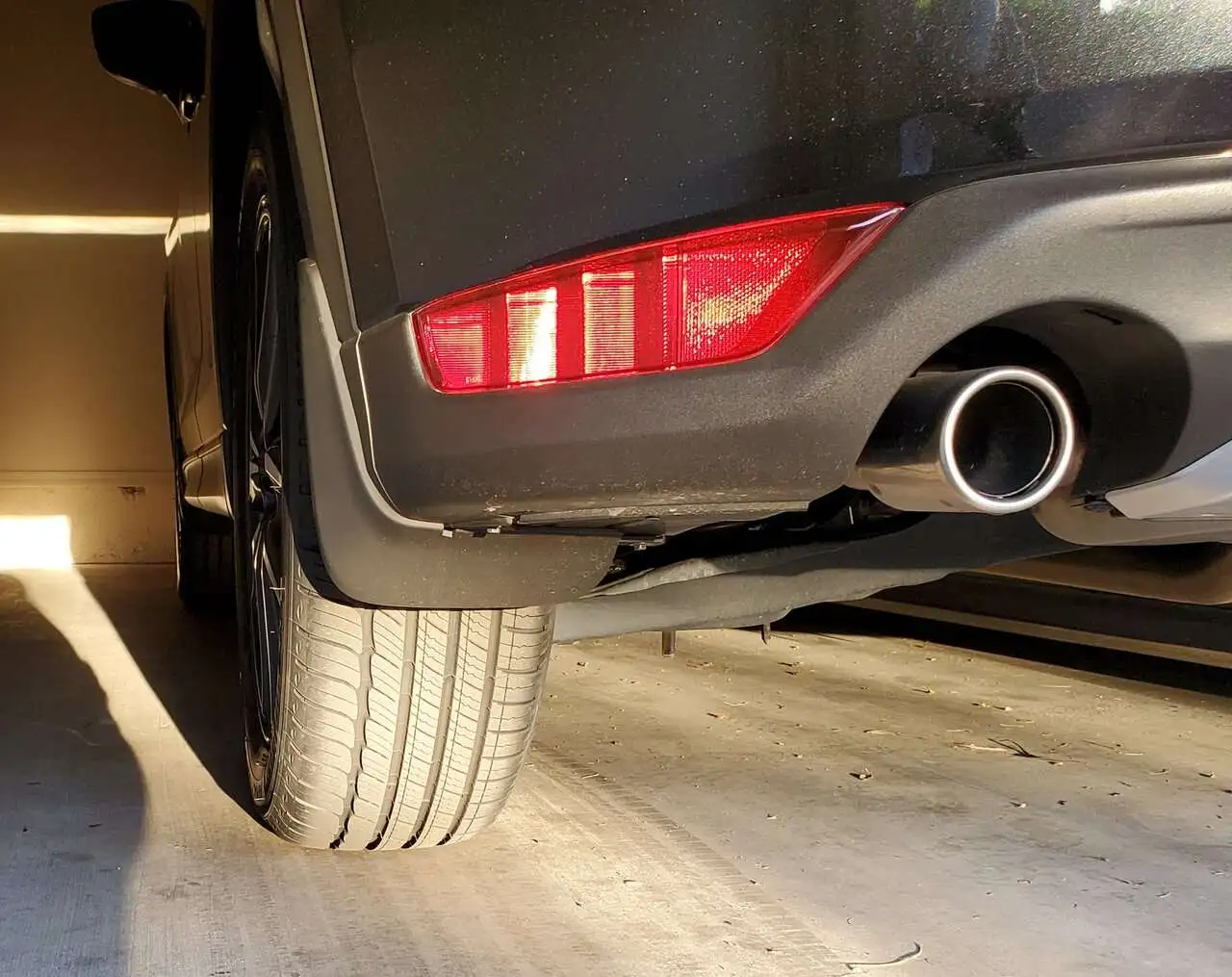

from those 3 listed,
Best overall in all main aspects is the Primacy Tour A/S to me. Your mpg will get a bit better as well. Its comfortable and very very good tire but not Lexus style comfort :)
for the most comfortable (see below). btw, The CX5 has just too sporty suspension.
For pure comfort this GoodYear model is most likely better based on my research but may lack in other areas where the Primacy Tour excels.
The CC2 is a good tire but its pattern is winter biased, mpg drops too and ride is questionable in the 19 size. I would not bother with those.

Did a lot of research before selecting them but 2yrs ago the Pirelli model was not available. People seem happy with the new Pirelli but they are quite new so I dont have any details on them how they do when they age.
